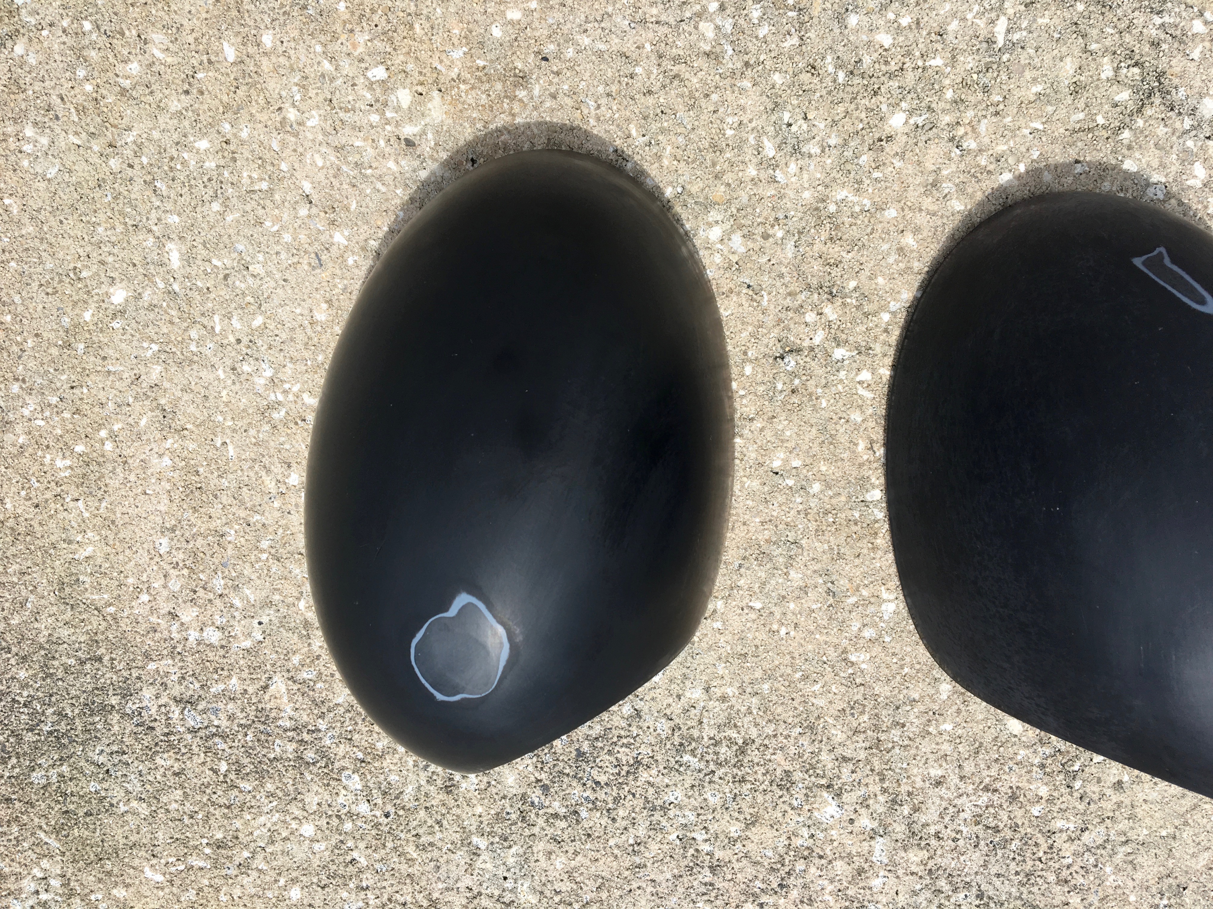

Here is what they looked like after I spent a few hours wet sanding them with 400 and then 2000 grit sand paper. I always wet sand, it keeps the sand paper soft so that creases don't put grooves in my work and it keeps the paper from loading up. I didn't take before pictures but just seeing the scuff throughs should give some idea of what they were like:

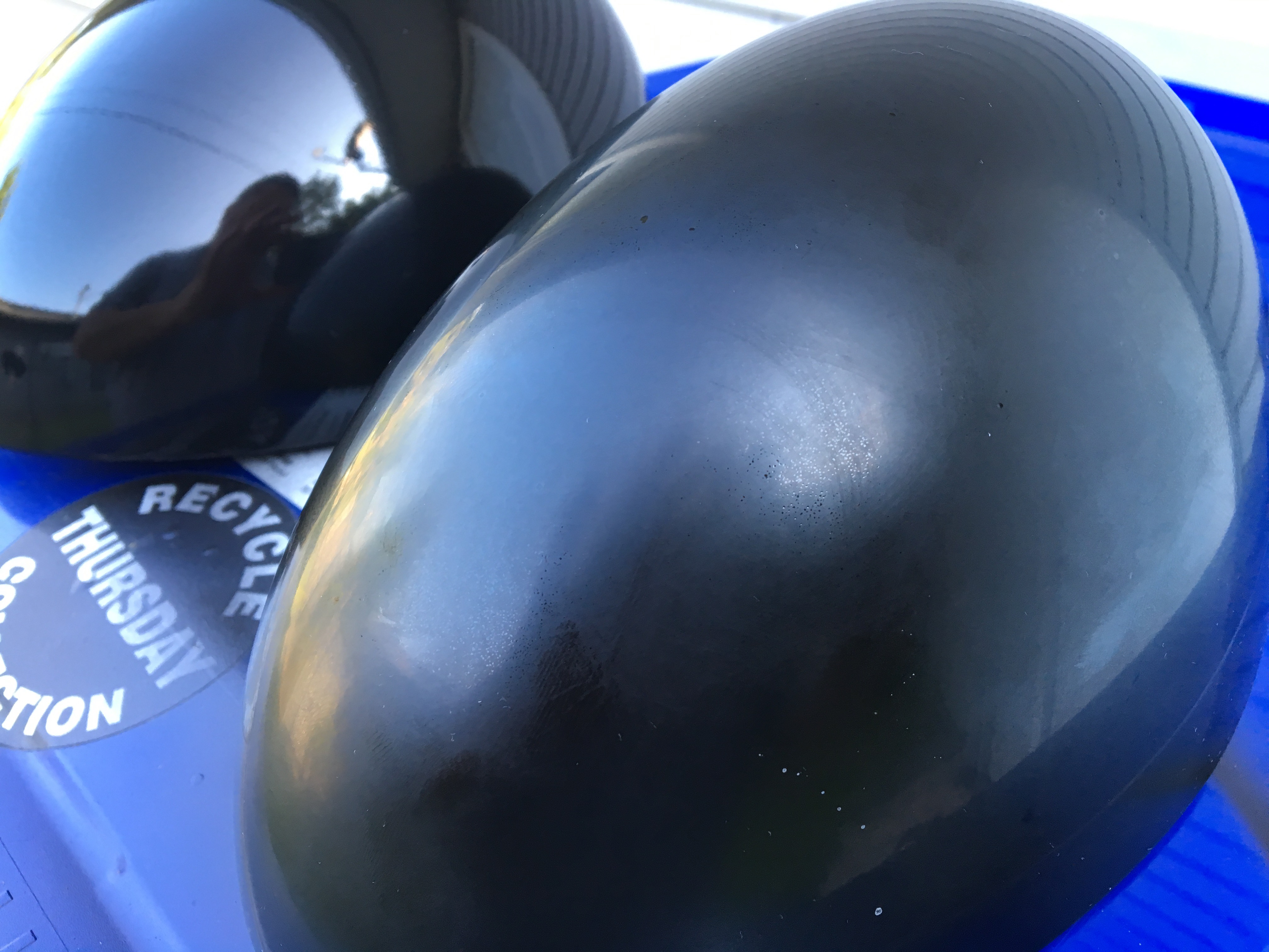

Here is what they looked like once this step was done.

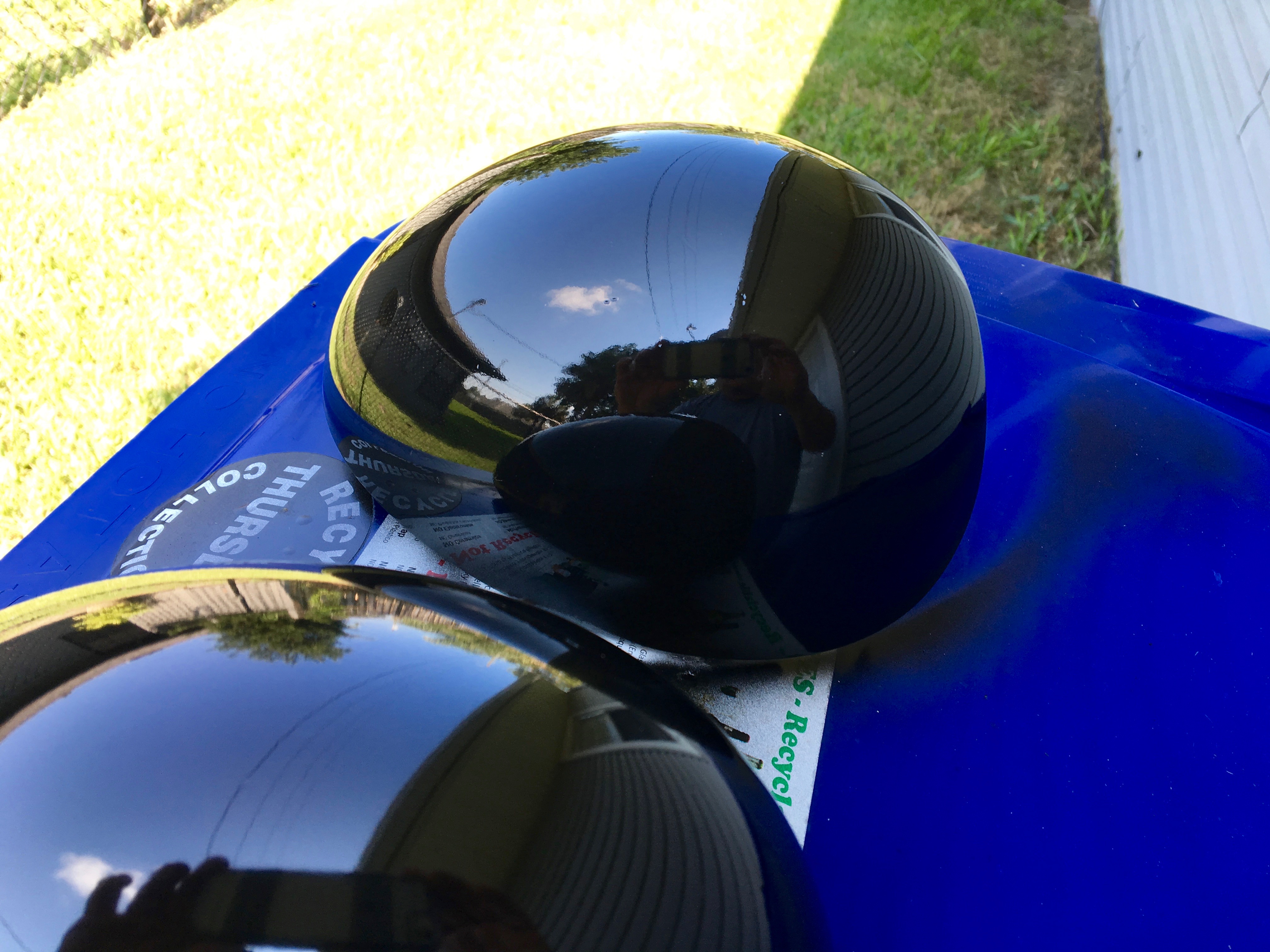

I let the caps cure for a couple hours after the last wet sanding. One thing that causes me issues is not letting the paint cure enough and putting another coat on top - the volatiles "leak" through the top coats and the final product never seems to dry correctly.
I actually took 3 days to do the project - but most of that time involved watching golf stuff on TV while the caps cured in the hot Florida sun. However, I think it is best if you bring the caps in after they have cured in the sun and let them cool to room temp before working on them or adding more paint.
At this point it was back to the paint and I added three coats of clear. I managed to get a drip and that required an hour of wet sanding to remove later. Whatever you do, if you get a drip don't try and wipe it off or remove it while wet. Suck it up and take your medicine - you're going to be sanding that away later.
Same process as the black coats. Let it cure and then wet sand it with 2000 grit sandpaper. Lots of elbow grease.

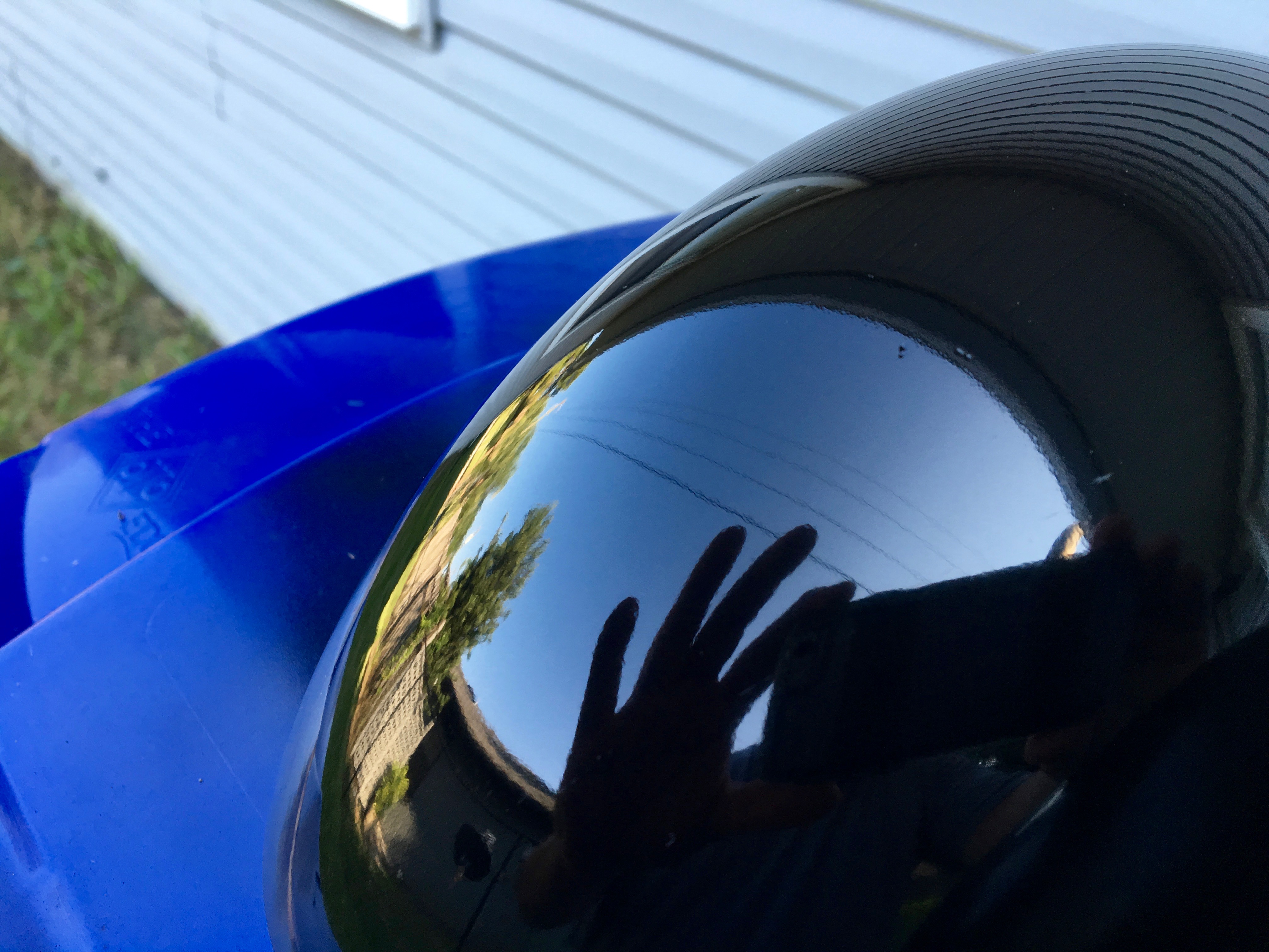

Once I had the imperfections sanded out and the cover feels nice and smooth (you will have to dry the cover and look it over and then go back and continue wet sanding to remove all the imperfections - you can't really see them when the caps are wet) I used compound to polish the clear coat. It takes time - don't press too hard. Be patient.
Here are some pictures of a wet sanded cap and a polished cap:
Last edited by scubus; Jun 15, 2016 at 07:33 AM. Reason: Oops... forgot to attach pictures

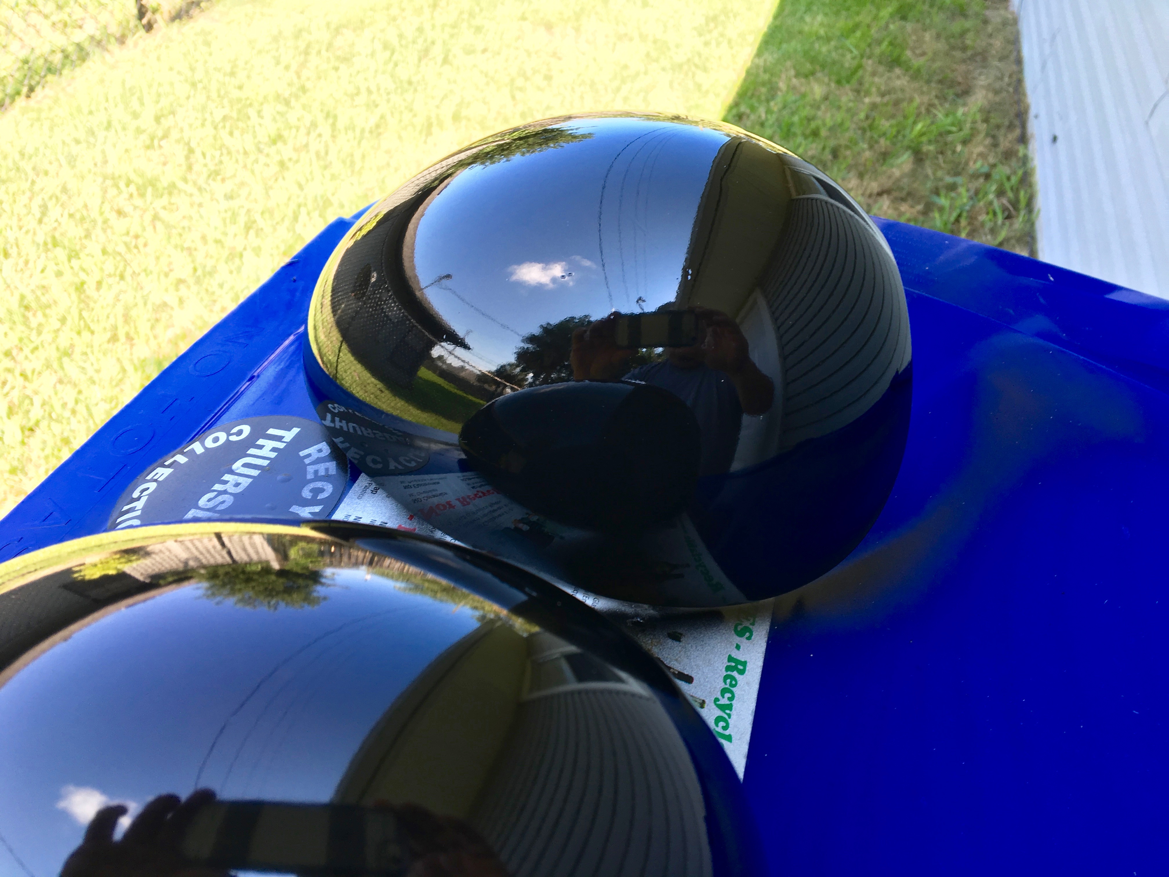

So, I'm going to post pictures of what I thought were the finished product, but I notice that I didn't remove the entire drip (they are a PITA which is why you want to avoid thick, drippy coats) so I'll have to go back and wet sand and polish again.
I will also put a final thin clear coat on them and sand and polish it just to add extra depth.
I use Mequire's Ultimate Compound and Mother's California Gold Carnuba wax. Be sure to remove all of the wax etc. if you are going to add any more coats of paint - rubbing alcohol works well. I used lacquer thinner but it mars any unpainted plastic, in this case the inside. It doesn't matter since nobody sees the inside but it annoys my sensibilities
I'll post a picture or two of the caps after I re-sand and re-polish them.

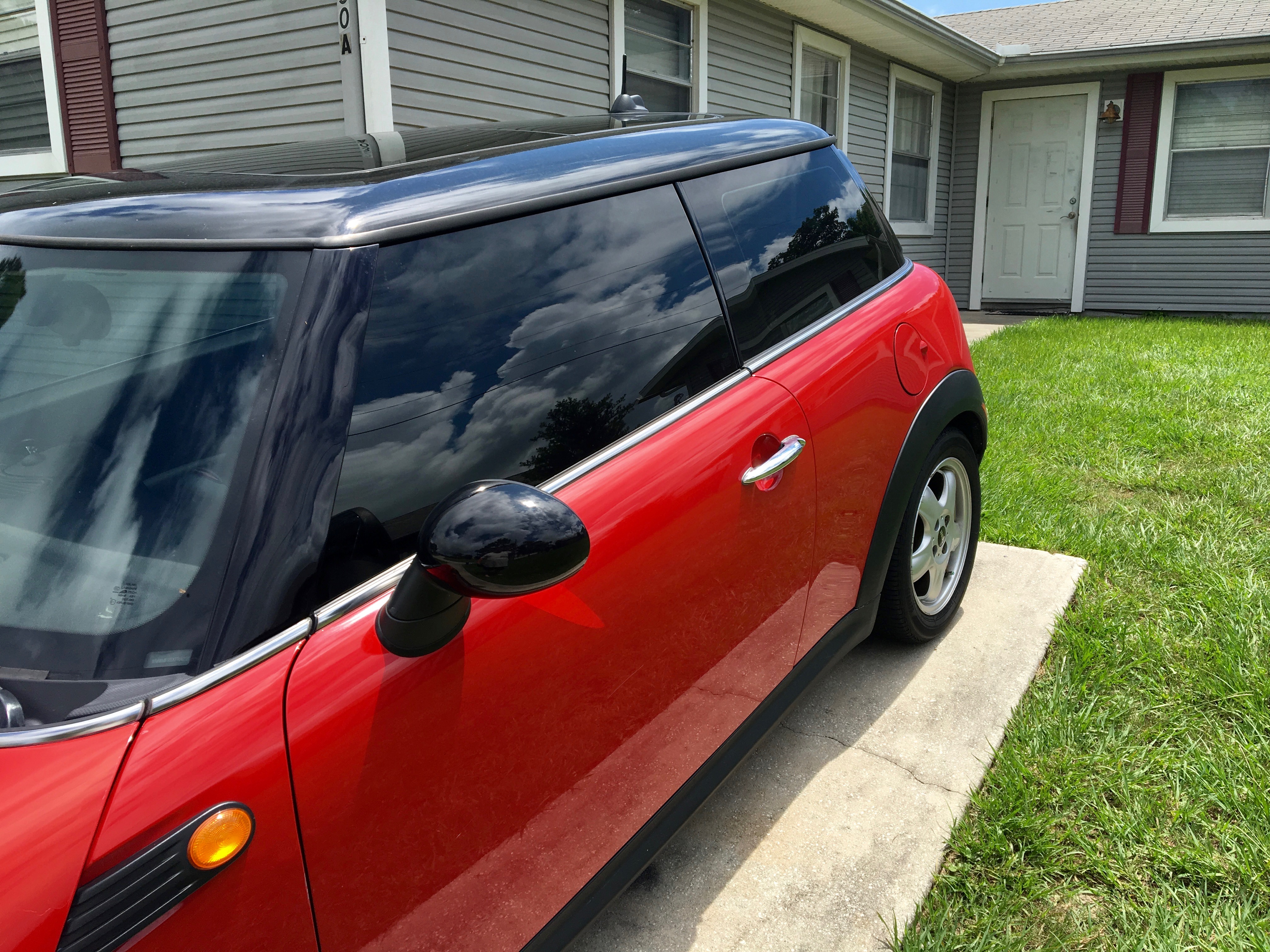

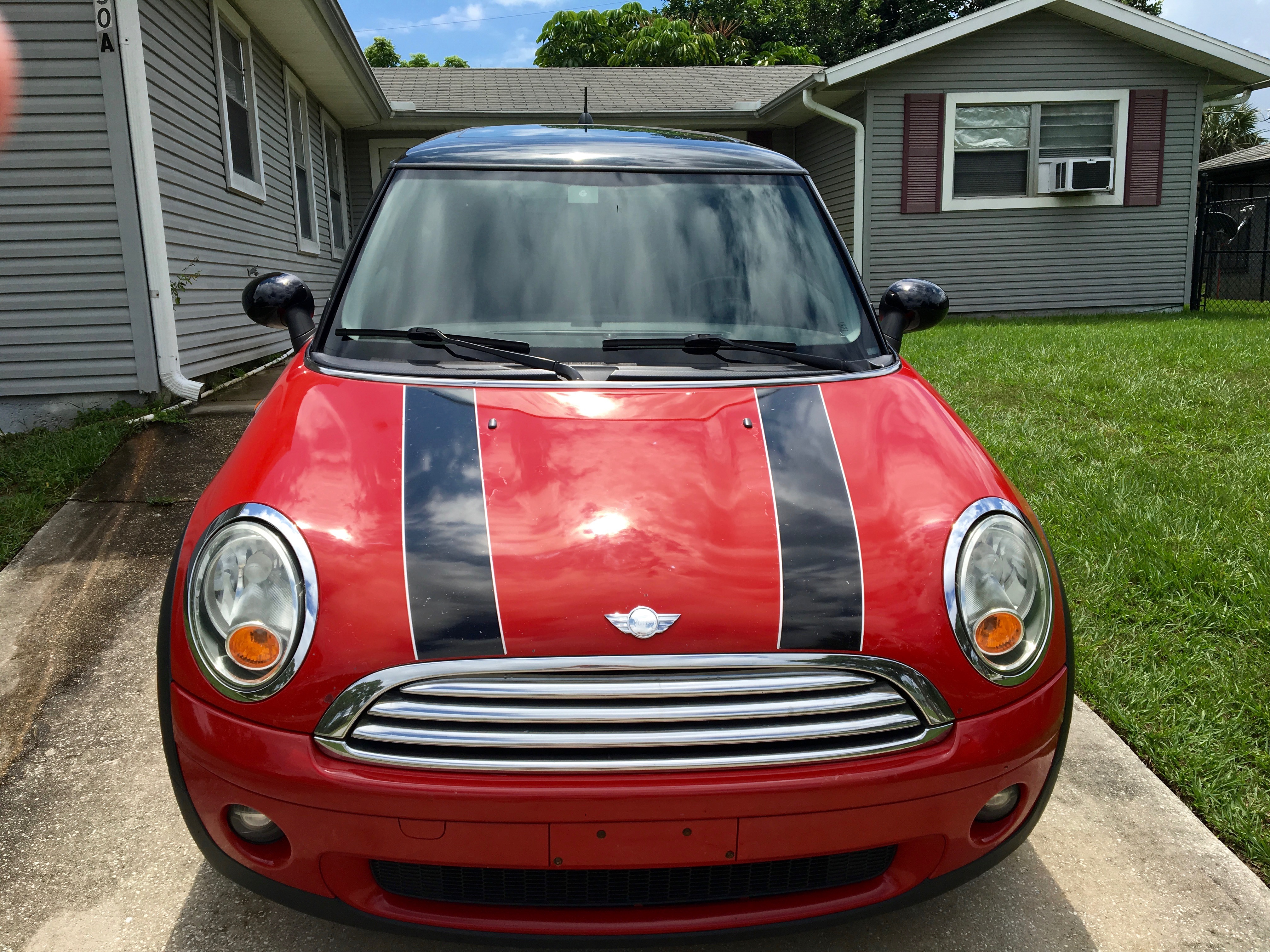

At this point I am actually sad I didn't go with Chili red so I could switch the caps back and forth. Not sure how red caps would look, but hey, it is an opportunity to post a gratuitous picture of Tater.
I am using Krylon ColorMaster. It covers well and looks very good. I may re-do them however, the ColorMaster doesn't feel "hard" enough. It doesn't scratch etc. but it feels soft - can't really explain it any better than that.
