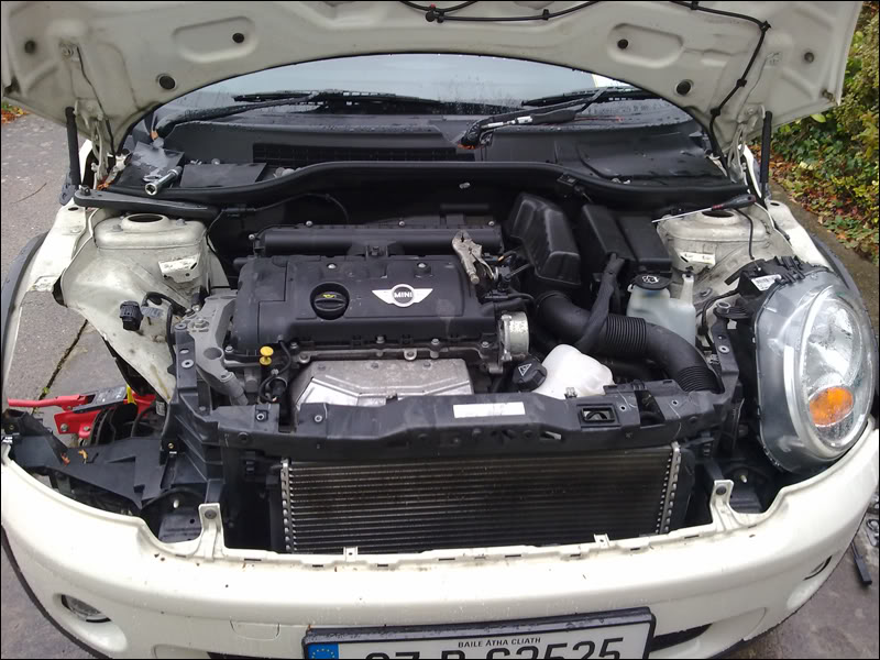

Non-turbo. On the right side of the picture, there's a box in the intake piping that almost looks like a smaller air filter housing. That's an intake muffler. As the name suggests, it's job is to muffle intake sounds. I'd like to hear more such sounds, so I'd like to eliminate it.
Not my car, but it's the best picture of a non-turbo engine bay that I could find.

That's been done many times; I tried it here https://www.northamericanmotoring.co...-for-25-a.html. Other folks have used silicon tubing. VIP sells one similar to mine if you're not the DIY type. I don't believe there's any power to be had but you do get a throaty sound from under the hood if that's what you're looking for.

I removed my intake muffler thing... and put it back soon after. Running without it gives a boomy and unpleasant sound, especially at highway speeds.
Try removing it and you'll see what I mean. Just don't get rid of it or lose it - - you'll need it when you decide to put it back.
