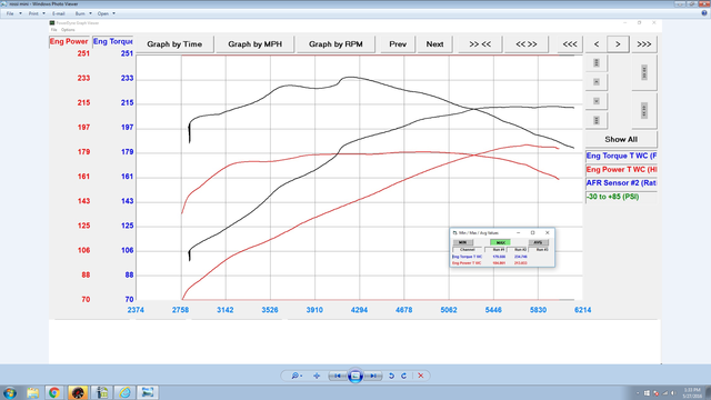

When I got to work we strapped her down on our dyno to get a baseline. It made WAY more than I thought it would. Now, keep in mind we have a Mustang dyno which is notorious for reading low. With that being said, on this EXTREMELY humid/hot day, the bone stock car put down 184whp/179wtq. My tuner got to work, we decided to keep it conservative until I get the supporting mods in (downpipe, filter or intake, methanol,intercooler, etc). After a few tweaks, we ended up with 213whp/234wtq... and you can REALLY feel it. I'd say I wish I had done this sooner, but I guess that would practically be impossible haha.
Anyways, I thought I would share with you all. As I add parts and keep adjusting the tune I will update the thread with the new hp and tq numbers. I would LOVE 300whp, but I don't see that happening on the stock turbo.

Nice. Which tuner did you decide to go with? Custom tune? What's up with that dip? Wheel spin?

We do all of our own tuning in house. The hardware we used for my car is called CMD. The dip, while it looks substantial is actually only like 3hp. Roshan (our tuner) said the dyno RPM was a bit jittery when the car spooled. I wouldn't be surprised if it was a bit of wheel spin as well.

It looks from that torque curve like the DME is pulling some timing at about 3600 RPM. The day you stopped in was a pretty hot if I remember correctly, so it could very well have been your IATs that were causing it. If you were doing multiple runs than the stock core would have heat soaked. We have published data on temperature drop and recovery rates of our intercooler. We also have data on how our cooler performs vs. other coolers on the market. A good intercooler would no doubt give you even bigger torque deltas. Congrats!

IATs were 200.. so yea, she was getting hot. We did 15 or so runs total. I had them load up the fans and let it rest between every 3 pulls. I still havent gotten a chance to put my short shift kit on damn work getting in the way. Thanks again for having me, you guys have a terrific operation. Do you think with Meth i will still need an IC? I'd imagine the methanol will more than adequately cool the car, right? Maybe i'll pick one up anyways. You said you're out of stock for a month, right?
