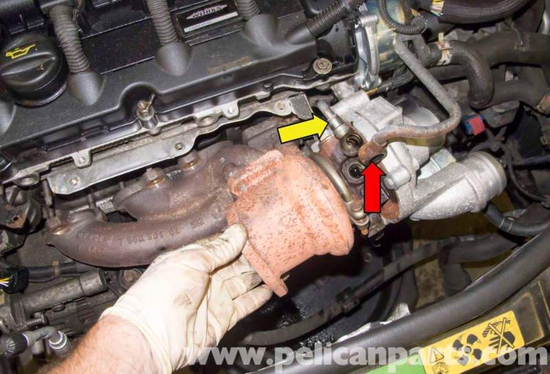

Yes, I've seen this a few times before. If you need help, we have a turbocharger replacement article on our site that can help you with the replacement. It's under the tech info tab at the top and the last article under the R56 articles. Turbo HERE if needed.
Oh trust me, I have already read that through many times. That is such a fantastic write up. The pictures help out a lot too.
