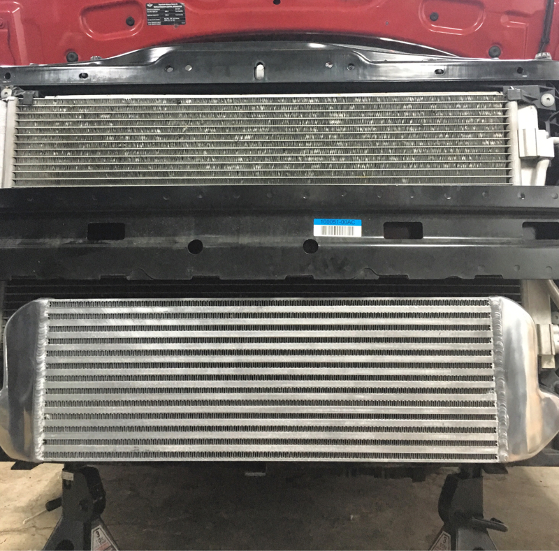

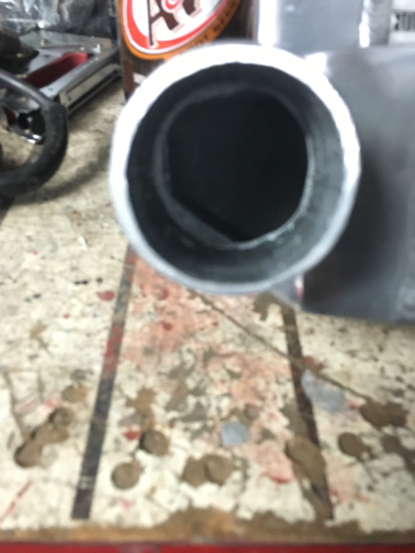

I bought this same cooler from the same seller on Ebay. http://www.ebay.com/itm/Front-mount-intercooler-BMW-Mini-Cooper-S-R56-R57-FMINTR56-2007-2012-Alloy-/201511109334?vxp=mtr&hash=item2eeaff82d6 1. It works great! It keeps my temps 2-3 degrees above ambient when in boost. Keep in mind I'm in Michigan and we haven't have hot weather yet so that could change. 2. There is a flaw with these coolers and you can see it in the pictures. The openings have a lip inside from where the ends are welding on. I removed the lip with a die grinder and smoothed out the inlet. Make sure you flush it out after. I used a shop vac to blow air out as I was grinding. 3 Shipping was quick. Took a week and was well packed so no worries there. 4. For 200 bucks I'm happy as hell.

WOW that is great!!!! I saw the lip on the picture. What about fitment? do you had any issue?

Fits perfect. No mounts needed, when connected to the hoses it doesn't move.

What does hold it in place? Is it just sandwiched so tightly that it cannot move? I am just concerned that it may rub on something enough to damage itself on the rubbed-upon pieces, or damage what it does contact. Any insight?

The nipples fit through small holes in the core support. Once the hoses are connected it can't move. There is nothing for it to rub against. Take a look at the early Helix cooler, this is a damn near copy.
