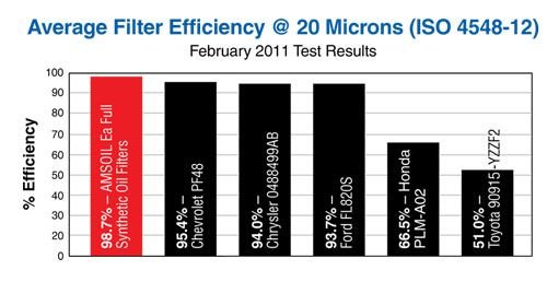

This out this little chart from that website...
In summary, DO NOT waste your money. You are getting gypped if you buy this contraption.

Thank you for attaching that chart as it showed me that I should switch from the OEM filters that I had been using in my other cars. Amsoil is partnering with Mann for the filters they spec for the MINI and these are the filters that I have been using in mine.
