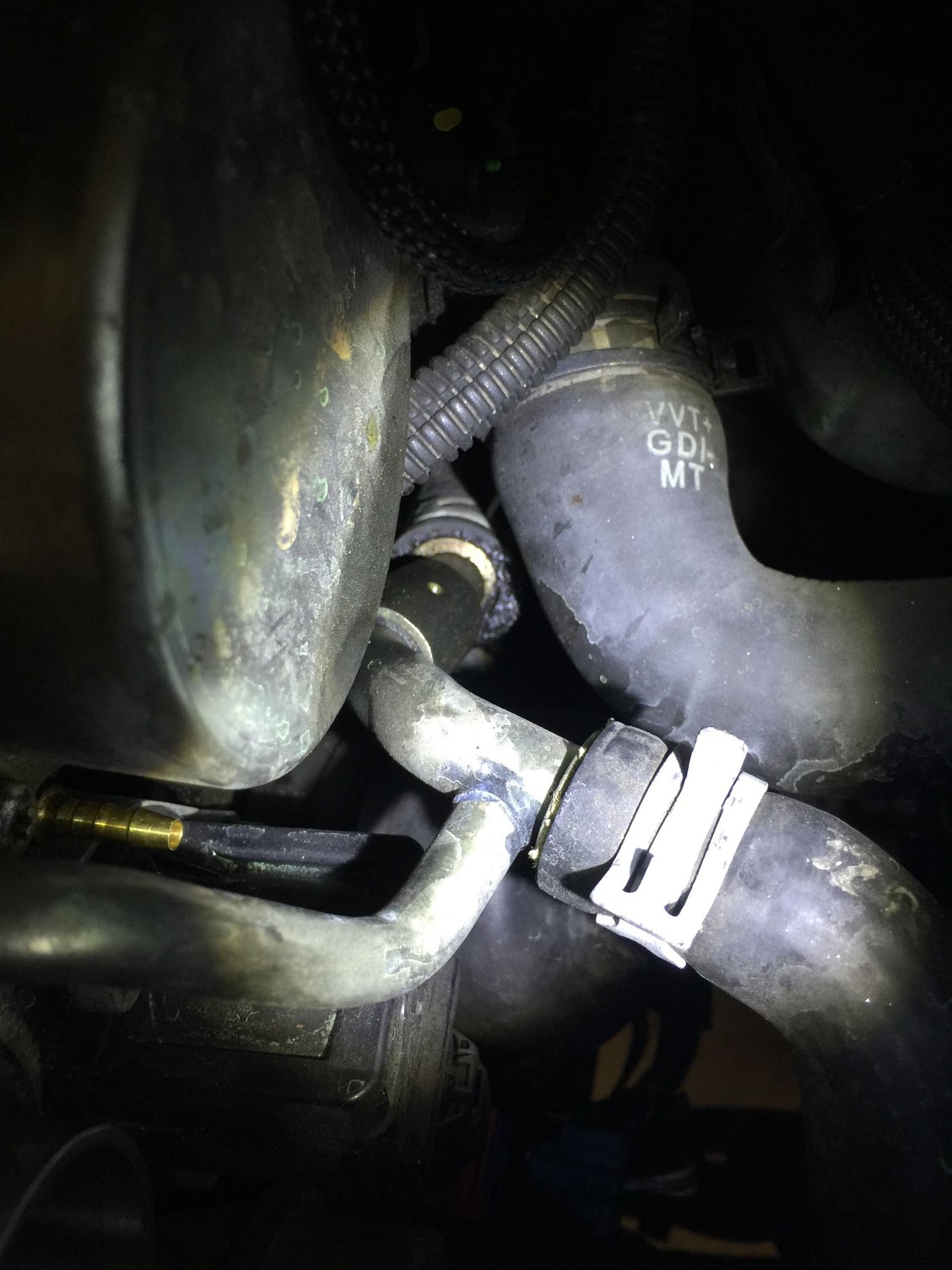

So I just got my first Mini the other day, and I had hoped to use the forum for good things only.. But of course I'm burning some oil and my coolant seems to be low, always. I purchased the car and immediately drove it about 20 miles. At a stop light I noticed some smoke coming from the engine By the time I got home I noticed it was slightly worse, but still nothing too bad, kind of like when you spill a lil extra when topping off the oil. Anyway, I pop the hood, look everything over, and the car seems clean. I popped open the coolant reservoir a little bit later and it was bone dry... So I went to BMW (in my work car ) and got a gallon of the good blue stuff. Went back, poured half of it in til at full mark. Drove around, still had burning oil smell, but when I got home, coolant was low again. I let the car cool off, filled it back up to the max line, turned it on and let it run until some coolant was sucked down and it was at minimum line. Then I added enough to put it back to normal (almost a gallon...) I'm wondering if I need to change the coolant thermostat that supposedly goes bad on the R56s? Any thoughts, suggestions? I can't find/see anywhere else that it is visibly leaking from..
I ended up changing the valve cover and gaskets since I saw some oil around there and one of the bolts especially and figured since it seems to be a common failure on these cars I'd have my problem solved. Well, its not. The VCG is completely sealed and oil free now, but I'm still getting the burning oil. After searching around online it looked like some people experience leaks from an oil line going into the turbo? Where/what would this look like? From under the car I can see an obvious oil trail coming down from the driver side of the engine, but I still can't pinpoint an obvious source.
Any help is MUCH appreciated guys/girls. Below are some photos to help with the puzzle.. Thanks
Bottom of engine looking up. Obvious trail of oil starting from that silver thing up top (what is that?)
That black tube in the background with the metal tube coming out... It looks like a coolant line but also seems like a culprit for leaking oil?
Trail of oil from up on the drivers side of the engine...
Another shot from under the car showing the same trail of oil...

Bet the oil feed line to turbo is leaking oil.....I would also replace the oil filter housing gasket and the Coolant gasket for the heat exchanger that is piggy backed there on the oil filter housing...

Turbo oil line DIY here and well as the oil filter housing gasket, I did mine on my R56 MCS at the same time since i was there. It can also leak coolant from the oil filter housing gasket as the gasket traps the coolant going into the oil filter section as a cooler.
https://www.northamericanmotoring.co...-oil-leak.html
The thermostat housing usually leak on the back of the transmission, but best to get that out of the way also: 11537534521
https://www.northamericanmotoring.co...8-no-heat.html

Here is the write up for just the oil feed line: Detroit Tuned TOL Install
I would recommend replacing the oil filter housing gasket as well.
We sell a kit that contains everything required to do the job, our line will remedy the oil line leak for good, as well as replaces all the necessary leak points in that vicinity. Detroit Tuned TOL Super Kit In stock and ready to ship.
Your vacuum pump may also be leaking oil, you can remove it and re seal it yourself if you have the time.

The thermostat is either going to leak or have a faulty temp sensor. If you aren't having trouble with it yet there isn't any need to replace it, in the long run you would save about $20 in coolant by doing the thermostat at the same time as the super kit install.

Two ways, you have a leak on the bottom of the thermostat, which then pools on top, then does not drip down the bottom. Or you have a fan running much too long, even when cold. You have a CEL for the thermostat sensor. Can be signs its bad, other then maybe the heater starts to get cooler at idle. And warms up when car is throttled. But steam back to seeing the leak.

If a fault occurs in the thermostat, a fault code is stored in the ECM, usually with a description of "Map cooling circuit". A fault code can be present yet the vehicle will lack any cooling system issues, such as overheating. This is because the thermostat has a fail-safe mechanical function as well. If you have this fault code, replace your thermostat and bleed your cooling system. Other symptoms of a faulty thermostat are engine overheating, slow to warm up and lack of heat. The thermostat could have a hairline crack and pooling on top of the transmission. A pressure tester is the quickest way to find these leaks if you cannot find it. Depending on what you find we have some great overhaul cooling system kits HERE or just the thermostat.

Oil leaks I had to fix.
OFH gasket-initially suspected turbo oil line.
Vacuum Pump-mounts to the drivers side camshaft.
Crankshaft oil seal
My thermostat housing cracked and leaked a lot of coolant onto the top of the transmission housing.
