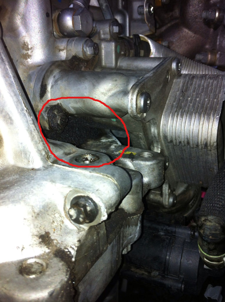

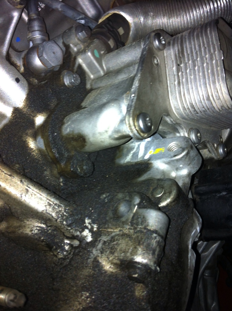

was hoping my 1st post would be an intro thread but got an unsuspecting problem...
took apart the mini for what i thought was the oil feed line leaking but it doesn't appear to be that..
what can it be?

i think it coming from somewhere back here

It's the oil filter housing gaskets. We have just started to see them, so we started to stock that set. It's an easy swap at the point your at. You will also get coolant out of the car at this point also. HAVE A PAN READY.

remove the three bolts, remove gaskets, clean up everything, add new gaskets, reinstall bolts. tighten to 7-9 ft lbs. i don;t have a link but the i think the gasket is 20 bucks. you need #5.

I just did the seals. Fixed the issue. Make sure you clean the area of oil residue and coolant and then bolt it back together with a new gasket set. I did an oil change afterwards and add more coolant / re-bleed the air out of the coolant system. To make sure things are clean.
#5 in the picture, that goes against the block, they seep a little bit when the engine is hot.
Gasket Set #5 Part number.
