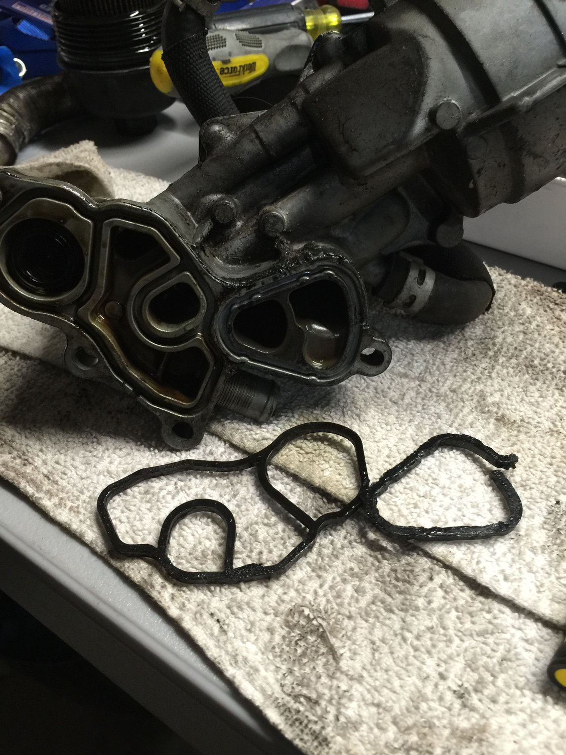

Originally Posted by 3lusive
I'll be doing the same exact thing, my dealer just found a coolant leak and suspects the oil cooler gasket. So I figured I'll replace the turbo oil line at the same time, and maybe even install a new DP for my future Stage 2 Manic tune. Dealer wanted $1200 for the oil cooler gasket replacement! But if I and a couple friends can do all these things for maybe $200 (excluding DP) that would be awesome. I've done brakes, short shifter, and oil changes so this will be a new experience for me. My car has 75k miles on it and I'm contemplating getting a new MINI instead of this, but since it's all paid off and otherwise running great I might as well keep it and then make it even better!
I really appreciate all the vendors on this forum, they make daunting tasks like this less stressful. I'll probably order the super TOL kit from Detroit tuning. Any good catted DP's I should look at? I have the fJCW exhaust and love the noise level, not too loud but not too quiet, and I don't want to introduce any drone.
not sure if you've already jumped into getting your oil filter housing off, but I found that moving the coolant reservoir and then bending this large black hose from the turbo back, let me have just enough room to remove those two stubborn bolts from the aux water pump, allowing me to easily drop the OFH down and out. Finally! Hope it helps. Good luck
Those gaskets were pretty decroded!
I loosened and bent back the large rubber hose going into the turbo giving me enough room to get down and see the two aux water pump bolts which I then removed.

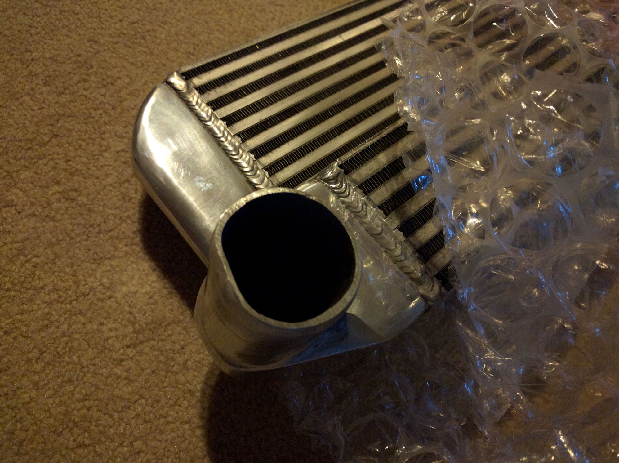

This is very off-topic, but I bought an IC and DP to install at the same time as the turbo oil line kit, and I noticed that during transit one of the tubes on the IC got a little bent.
Will this end up being an issue with the performance of the car at all? Since the hose will fully enclose this tube end, I don't anticipate any issues but I thought I'd get some opinions too.

If the hose goes over that bent part enough to make a good seal with the clamp I don't foresee an issue. However, wherever you bought it from (unless it was a private seller) should have shipping insurance on the product and be able to send you a new one due to poor packaging.

It was a private seller. He showed me a pic of what it looked like when he took off the IC for shipping, so the damage must have occurred through shipment. When I put it on in a couple week's i'll evaluate if it looks like a solid fit. Otherwise I may have to try and hit that flat spot to get it round again...
Try to bend it out a bit, be careful if its ebay one ( so it will not crack, if you slide the hose enough and clamp it , it should hold.

Bring that intercooler to a radiator shop, they have the tools and experience to fix it.

Good ideas all around. Thanks, I'll probably try calling a radiator shop to see if they can fix it.

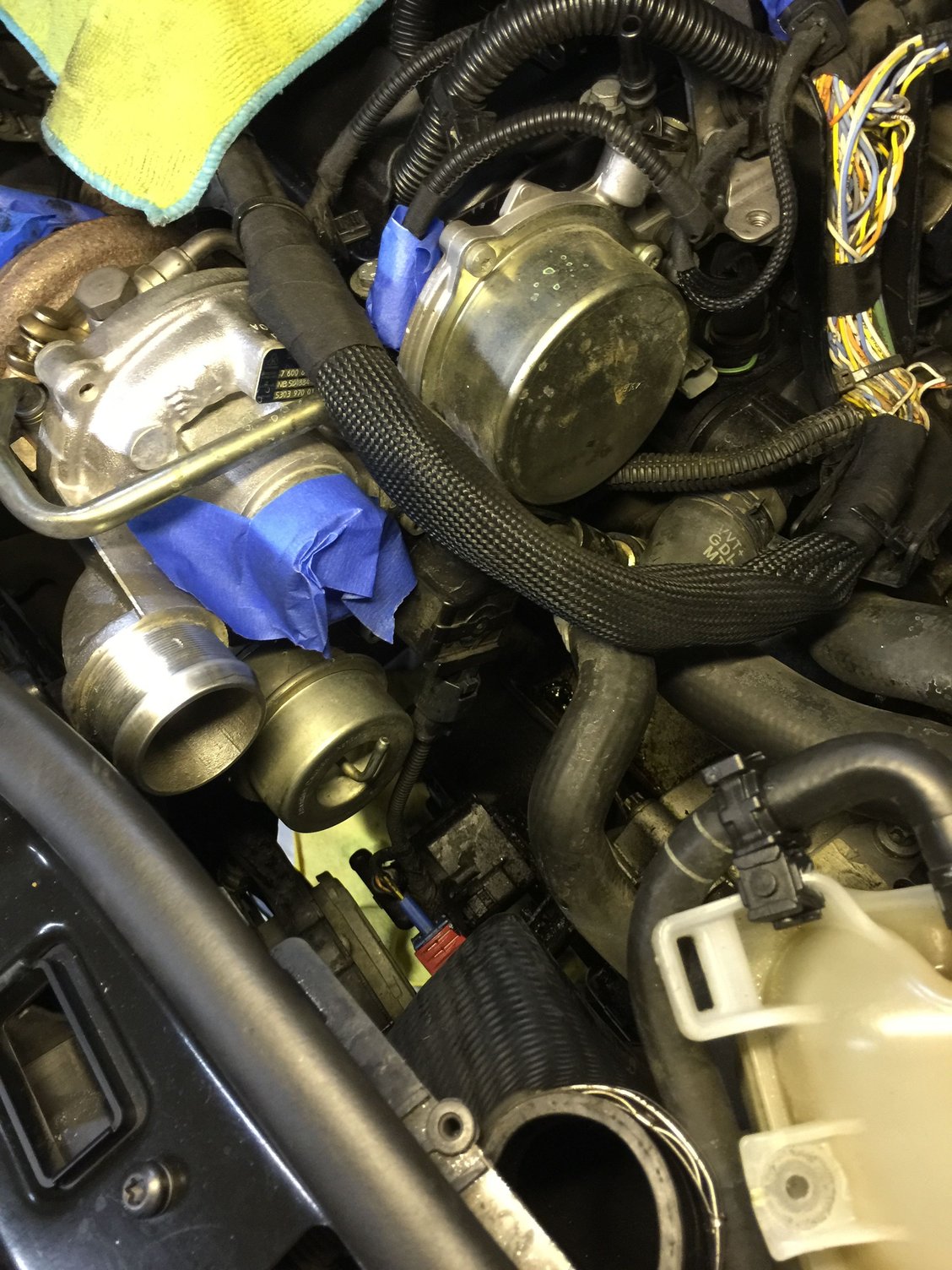

Alright, so just an update. I was out of the country for the last few weeks, but right before I left I finished changing the OFH gasket, oil filter, oil, the turbo oil feed line via the super kit from detroittuned, as well as the coolant thermostat housing. Before I finished I noticed a hairline crack in the coolant expansion tank. So I ordered one, and put it in. I got back into town today, swung by the BMW dealership, picked up coolant, and headed home to fill her up and get back on the road! I tried pouring some distilled water into the system first (the guy at BMW said the coolant is very concentrated and to add some water when topping it off). Unfortunately, all I heard was water splashing down below the car on the opposite (passenger) side of the engine! Now Im wondering if I need to change my water pump? Or what might be dumping the coolant out the passenger side of the engine? Im 99.99% sure all coolant lines were reconnected properly, but I'll probably start by checking all this tonight/tomorrow.. Any input would be appreciated! Thanks all!

Coolant leaking down the right side of the engine could be the water pump. Since you heard it happen right away, have someone add in water while looking under the vehicle to see if you can pinpoint where it's coming from.

I followed your instructions and it looks like the coolant line that sits right below the air intake manifold is busted and any fluid comes rushing right out of it? The connection towards the coolant thermostat with the wire clip is correctly fitted, but the other end of that hose seems to be out of place. I can try to take pictures but it seems like a PITA to get to.. I'll update tomorrow or the next day.

Sometimes the water pipe on the other side can crack . Should seat all the way in. You can see it seated in the back of the waterpump housing. bet when you move the thermostat housing you lifted the tub and it cracked at that end.
11537589713 Water Pipe
https://www.northamericanmotoring.co...8-no-heat.html
Awesome. Exactly what I was looking for. ill probably get that ordered while I search for a write up for changing it. Looked like I should take the manifold off and then I would have access to it from there. I just want this stupid project done with so I can enjoy the car!! Thanks ECS

Another plastic piece on the MINI that can tend to crack and cause issues unfortunately. The plastic gets brittle over the years. Some info in this thread HERE and linked to my post where you can see the clip that connects to the thermostat side. The first page has a lot of great info as well. It's definitely a hard area to work in and can be a pain, but just take your time. It's connected on the thermostat end and just sits snug against the water pump, not connected to anything, but it can stick to it so may take a little tug. The water pipe with o-ring is HERE with the clip below it.
