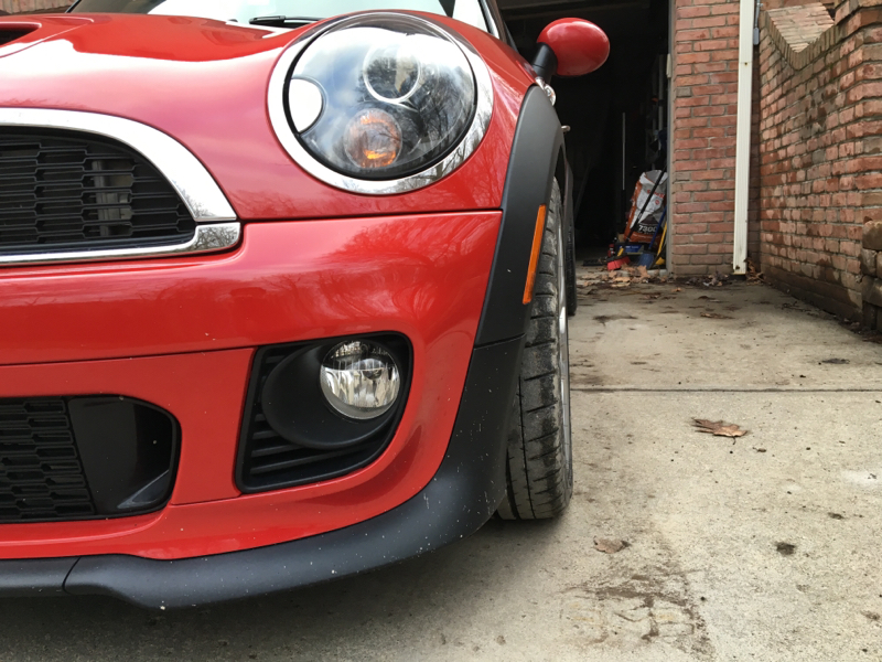

Thanks for the purchase of the 8mm wheel spacers, post up some pics, would like to see the fitment.

Looks great with the 215 wheels, thanks for the picture.
I went 15mm with 205/45/17 for a flush fit. Those Michelin Pilot Super Sports tires are nice.

The 8mm look good , it depend on the wheel and tire size, since you are 215 the 8mm look about flush, i would bet even with the 215 you could do the 15mm. The GP2 brake kit is awesome, Its the best brakes I have ever felt on a MINI. The first time you switch over from the 4 pistons ( factory JCW full kit ) to the 6 piston gp2 kit , it was like wow. When we went form the Cooper S brakes to GP2 it was even a bigger change in dynamics.
