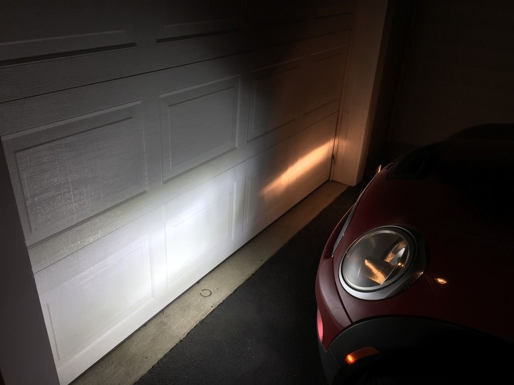

New Headlights and some Plasti-Dip
Since I had some time on Saturday I wanted to get the headlights installed and also do some Plasti-Dipping. I did the Front Emblem, Upper Grill Surround and the headlight surrounds.. Right after I had to stop because the temps dropped and it started raining.
As for the headlights they look amazing on the car, I still need to wire up the DRL's and decided to take out the LED Bulbs and go with HID's. The Pattern was wayyy off due to the funky LED Bulbs.. They do need some adjusting (to fix the gap) which I will do this week or weekend but overall im happy with the outcome.
Gotta order some Anti-Flick adapters on Ebay and everything should be all good..

From what I see in that photo, the headlights are well focused and throwing a tight beam of light. The lower lights are just blobs that look unfocused and may be throwing light everywhere. I don't think calling them "parking lights" is accurate any longer, and I'd be interested to know if they are actually throwing focused light down the road instead of in oncoming driver's eyes.
I'm not trying to rain on your parade, I'm noting that adding light in a poorly focused light housing can create some really obnoxious lighting effects. A parking light should be low powered and should only provide enough illumination to show where the vehicle is parked, or let you move through an area with minimal light. A parking light housing is not designed for higher power lamps, and it can become obnoxious to oncoming drivers if you go that route. Dodge Ram pickups are awful - the lights low on the front end are almost blinding at night.
I suggest going out to a dark road at night, turning on lights and getting out of the car, then walking towards it from 50 yards away. If you find the light from those "parking lights" unpleasant as you approach your car, consider removing the upgrade and going back to a light setup that doesn't cause excess light scatter. If they look OK, then you will be comforted that you're not causing a problem.

Truthfully once there in there they are not coming out... Looking bad or not as long as they are doing the job I need them to do..
