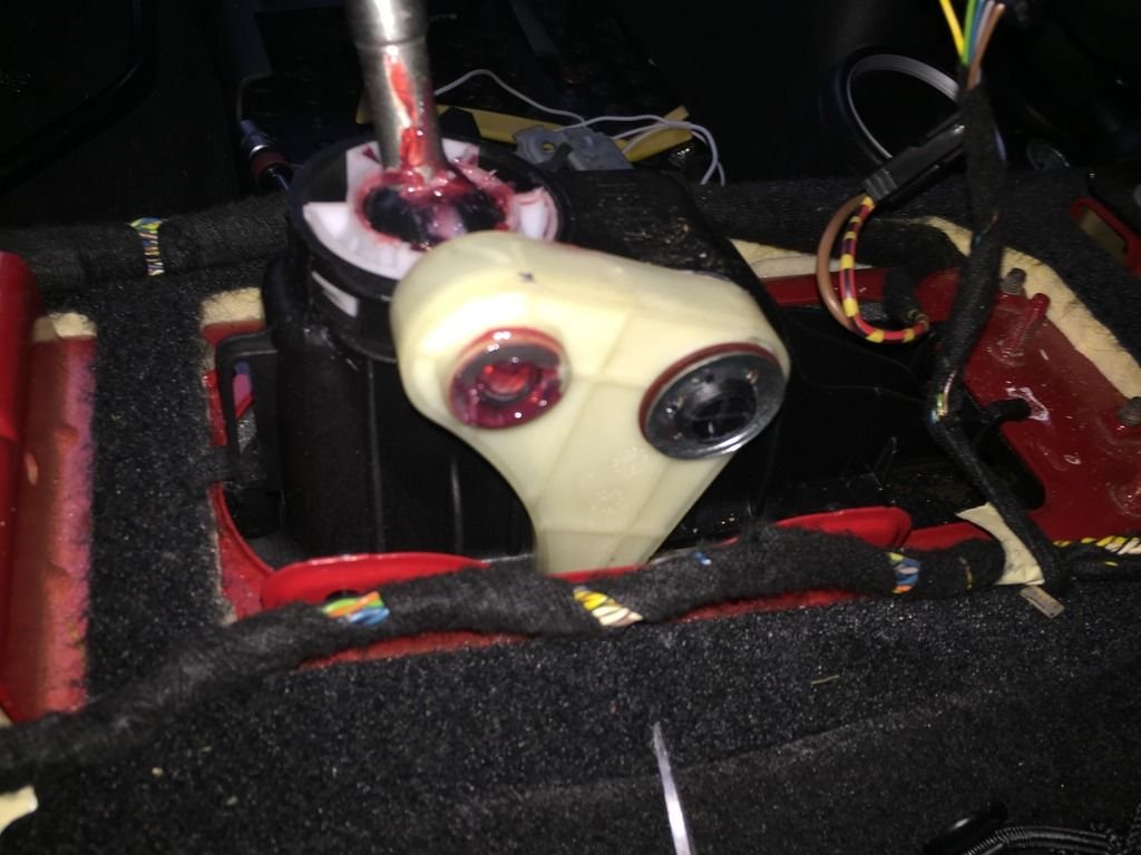

- I ALWAYS COMPLAINED HOW NOTCHY THE SHIFTER FELT AND HOW HARD IT WAS TO GO LEFT TO RIGHT.. AFTER TAKING EVERYTHING APART I WANTED TO START OFF GREASING ALL OF THE CONTACT POINTS AND JOINTS.. IT HELPED TREMENDOUSLY, HOWEVER I WILL END UP CHANGING ONE OF THE CABLES THAT WORKS THE LEFT TO RIGHT MOVEMENT. AFTER GREASING EVERYTHING UP THE UP AND DOWN MOVEMENT IS SILKY SMOOTH.. HERE ARE THE BEFORE PICS:
Little to no grease on anything..
HERES WHAT IT LOOKED LIKE AFTER I GREASED EVERYTHING UP..

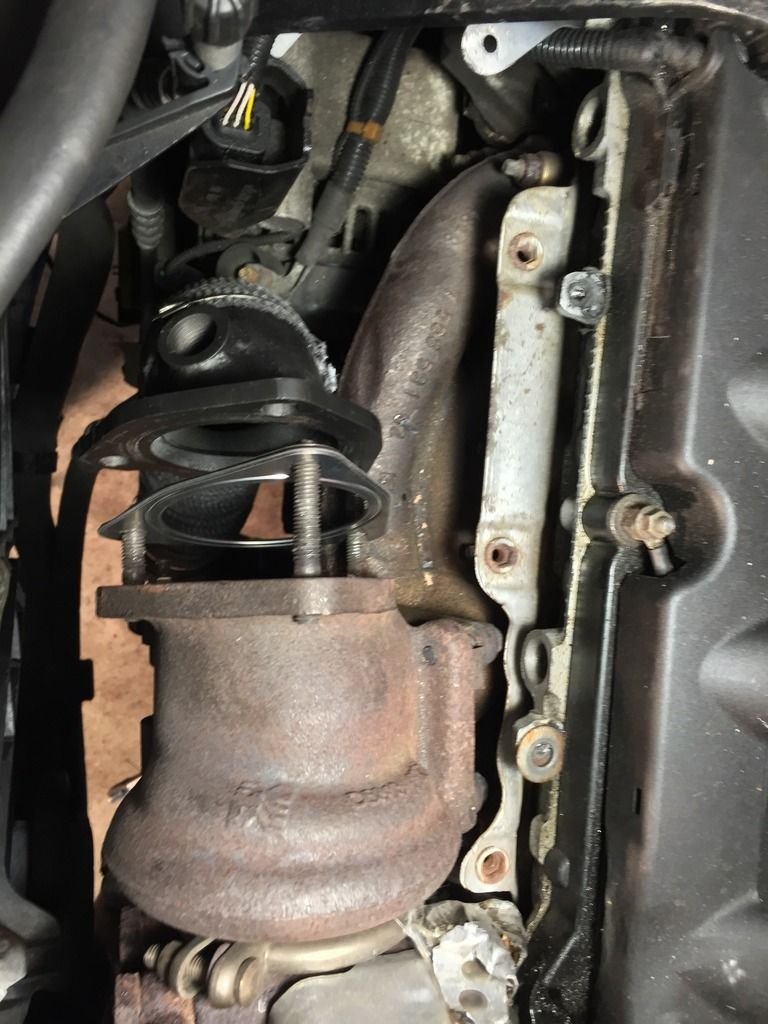

- FIRST UP WAS THE CAT REMOVAL. BELIEVE IT OR NOT IT WAS THE EASIEST CAT REMOVAL THAT i HAVE EVER DONE. TRUTHFULLY I WAS TERRIFIED AFTER READING ALL OF THESE THREADS. THE HARDEST PART WAS THE NUTS ON THE HEAT SHIELD.
- I RAN INTO THE SECONDARY 02 SENSOR BEING SEIZED IN WITH THE CAT SO I LEFT IT IN THERE AND ORDERED ONE OFF EBAY.
- NEXT UP WAS THE CNT DOWNPIPE INSTALL. THE DOWNPIPE WAS CERAMIC COATED AND WRAPPED AND INSTALLED WITH A NEW OEM GASKET.

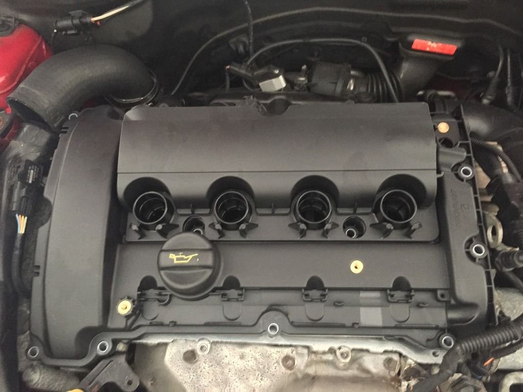

- I WAS GETTING A CEL AND ALSO THE CAR WAS RUNNING BAD SO I LOOKS AND SAW THAT THE VALVE COVER WAS CRACKED SO I DECIDED TO CHANGE IT OUT. WHILE AT IT I CHANGED MY DV AND INSTALLED THIS NICE SHINEY FORGE DV !

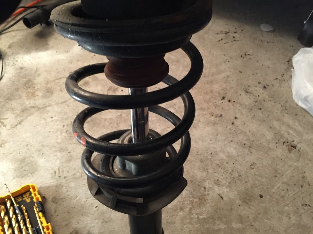

- GOT TIRED OF THE COILOVER AND THE RIDE SO I WANTED TO GO WITH A MORE STOCK LIKE SHOCKS AND SPRINGS. SOLD MY 16'S TO MY COUSIN FOR HIS R50 AND GOT A SET OF 17'S OFF A MEMBER HERE ON THE FORUMS...

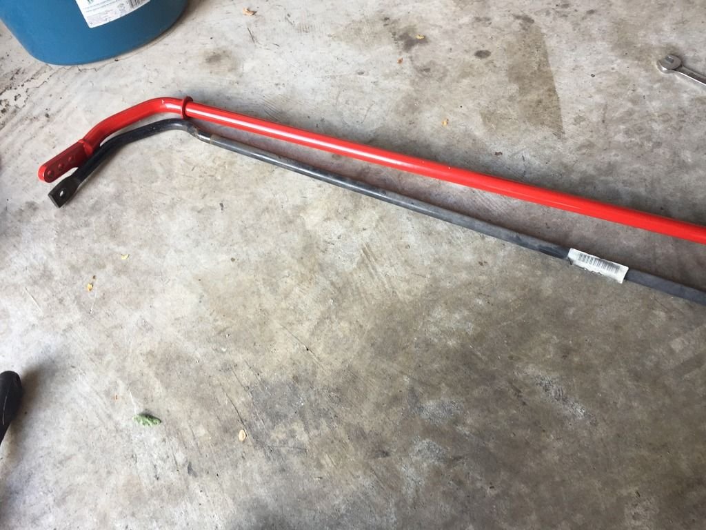

- INSTALLED NEW ALTA REAR SWAY BAR, NEW FRONT AND REAR MOOD ENDLINKS, EIBACH SPRINGS AND STAGG SHOCKS. I HAD THESE SHOCKS ON MY 330I BACK IN THE DAY AND THEY WERE AMAZING AND ONLY $150.00 ON EBAY. THEY ARE STILL GOOD 5 YEARS AND 45K MILES LATER ON THE CAR WHEN I SPOKE TO MY FRIEND WHO BOUGHT THE CAR OFF OF ME.
