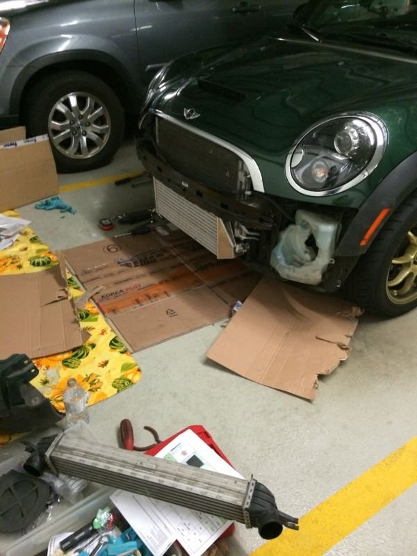

Forge intercooler installed. (Didn't wanted to get something too big for reason.)
Took this goose out of the car, to cut it and seal it.

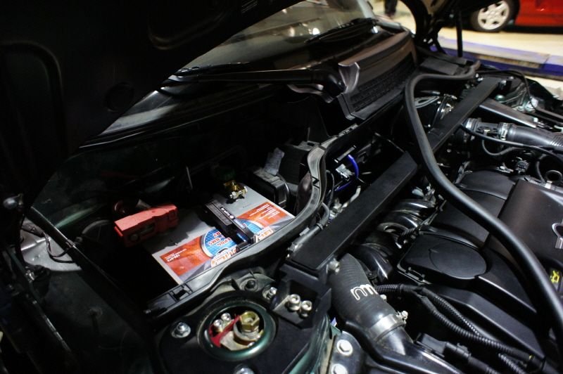

NM Charge/Discharge pipe was installed as well.
NM quality never put me down.
Drilling on bulkhead for DOS intake. I like the design and concept of DOS, but seems the filter is relatively small-ish for higher boost setup for the future.

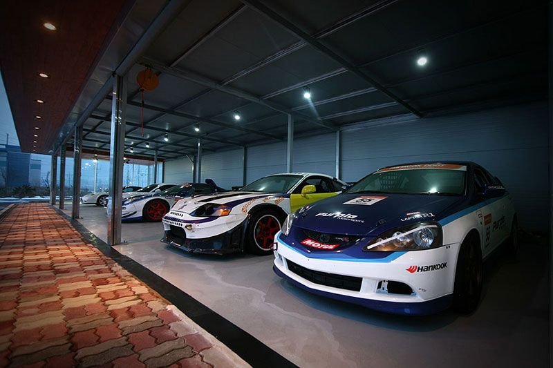

Race car storage

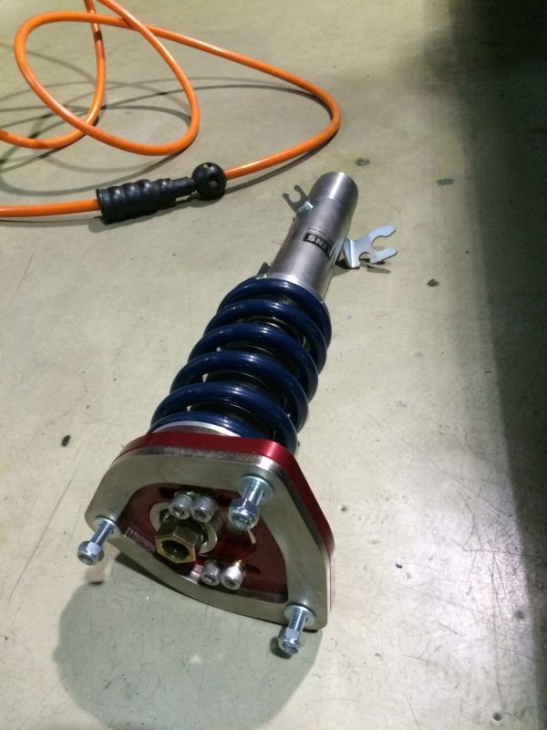

Hmm, at that time that was my best bet on suspension setup.
Ohlins Road & Track / Vorshlag camber plate / Hypercoil springs of my own choice / Hotchkis camber arms.
I like Vorshlag so far,, Durable under harsh track use. I hope it can hold one more season before over haul.
That setup was pretty nice for 50:50 track and road use since I had to use my car to participate Korean mini club meets,
but as I do more track activities, Road & Track was turned out not that customizable to achieve my own setup.
->Stroke(Travel) is too long especially at the rear
Basic damping is only good for roughly 450lbs springs
NOT A SHOCK BODY ADJUSTABLE... That gives me a lot of hassle now since I can't set my own preload for my local tracks.
Superpro Austrailia makes the best bushings.
I got caster increase offset bushing too give more caster at the front.
Result was very noticeable.
In the middle of 2015 season, I experienced annoying weired noise from the rear, turned out rear subframe shifted/tilted at the mounting position from the tough local track layout.
My aid was Trailing arm bushing and Spoon rigid collar kit(will post later)
Too bad Superpro doesn't make trailing arm bushing for R56, I used Powerflex.
During the season, I've tried several sets of springs for front/rear,
Diffrent rate and different length..
I should have gone someting more suitable for race..
I want AST5300 custom. (but that costs $7000 haha so not for now.)

Ballistic LiFePO4 with BMS.
Too bad, that type of battery wasn't suitalbe for mini R56.
Cranking power was okay, but I experienced sudden powersteering out, audio out, headlight out.
I guess electric steering and many other electric gadgets doesn't like the battery pulse/type.
It was so scary on the way back from the workshop to my place at 2:00 am.
I'm always aiming for building a lightweight car rather than powerful car.
Light weight battery was also one of the key to make it light.
Now I am using the smallest Acid battery available in Korea (23lbs),
and waiting to get an Braille AGM 2015 one, will relocate the location to passenger seat.

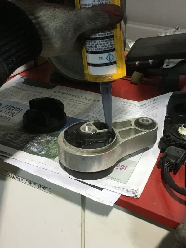

My NM(?) torque mount insert showed a little issue(stopper/holder gets bent, making mount rubber to come out from the housing under movement in my case), did some first aid with silicon injection.
Thinking to get BSH, anyone have experience?
I want not too harsh but firmer than "insert type" mounts. (harsh makes more trouble)

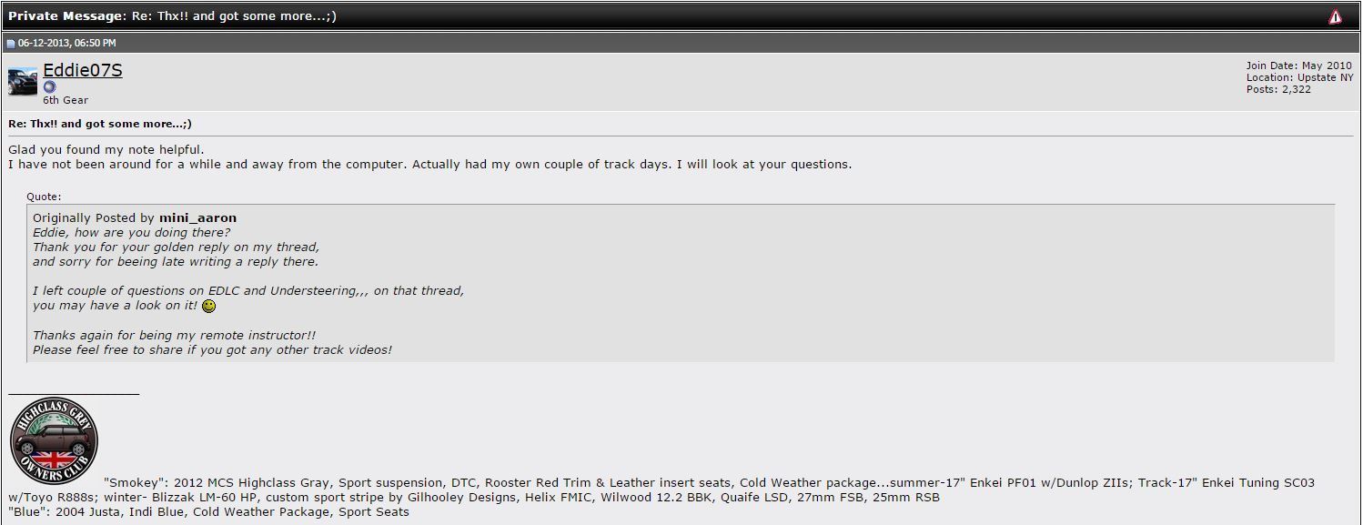

I'm glad that my pm box was keeping some of your pm from 2013.
Look at this
And from your reply, I can also see that you got even more experience with modifying/driving your track toy.
I am happy that you know how I was careful with picking and putting the parts for my mini - not just getting ecu tuned and shoot.
Sometimes my Korean friends pisses me off by judging my achievement with result of hardcore parts.
You know it's more like research and planning and.. most importantly.. passion.
It looks like you are really happy with your fron sway,, too bad I've dropped my front sub frame 2-3 times already without changing front sway.
(Last time I just put Superpro stabilizer mount bushing as a salt during the tranny job)
I really like Superpro quality, but proly will go with Hotchkis front since I am on Hotchkis comp rear one.
Thx for the reply!

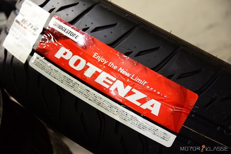

OZ 16x7 mated with 205 50 16 Dunlop Zii worked more than enough in terms of balanced performance, (especially when you have under 200hp..)
I decided to test something. Do something other miniacs not doing...
Bought only two weels.
Advan RZ 16x8.
Fortunately, 8 inch wheel was 2mm off from the Ohlins shock strut.
I had to guess on my new setup since no one provided such data especially on MINI.
And then, I had to import front tires from Japan, rear tires from US.
Since 225 45 16 Bridgestone RE71R isn't available at Tirerack.
How the Bridgestone sticker for JDM looks like.
Yes, I will enjoy.

I have mentioned that I had some issue with rear subframe tilting issue from track driving, So I wanted to try Rigid Collar from Spoonsports.
I DIYed. Took me 5 hours. :(
Rigid Collar is invented by Spoonsport racing team who were participating an endurance race event with their RL(Legend) race car.
Goal was to achieve "bonding/welding" effect between two different materials in body/subframe compartment.
Working for a main distributor for Spoon sports in Korea, I could get a good deal.
