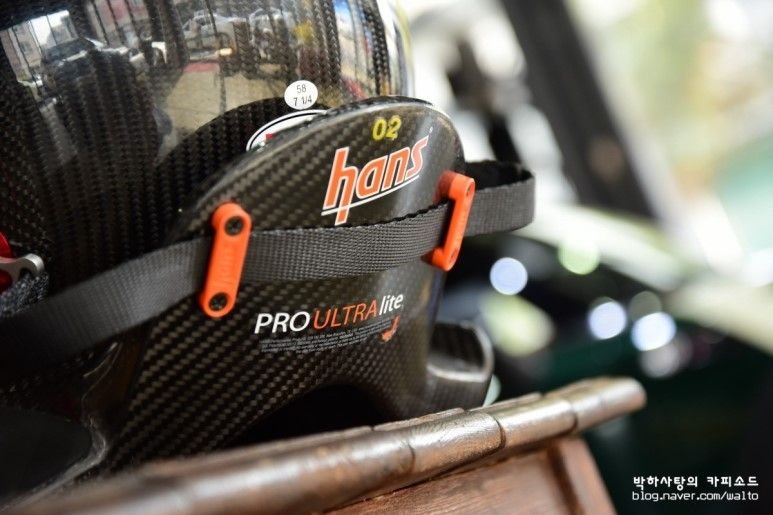

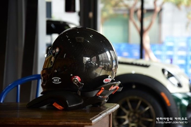

Acutally, I've started to use HANS after that track event,
you will be able to see i am wearing the device from the next update.
here is my device. (I am working at official Simpson/Hans dealer in Korea)

Detail shots from the photographer(below)
