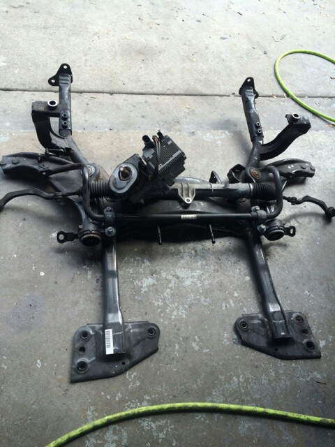

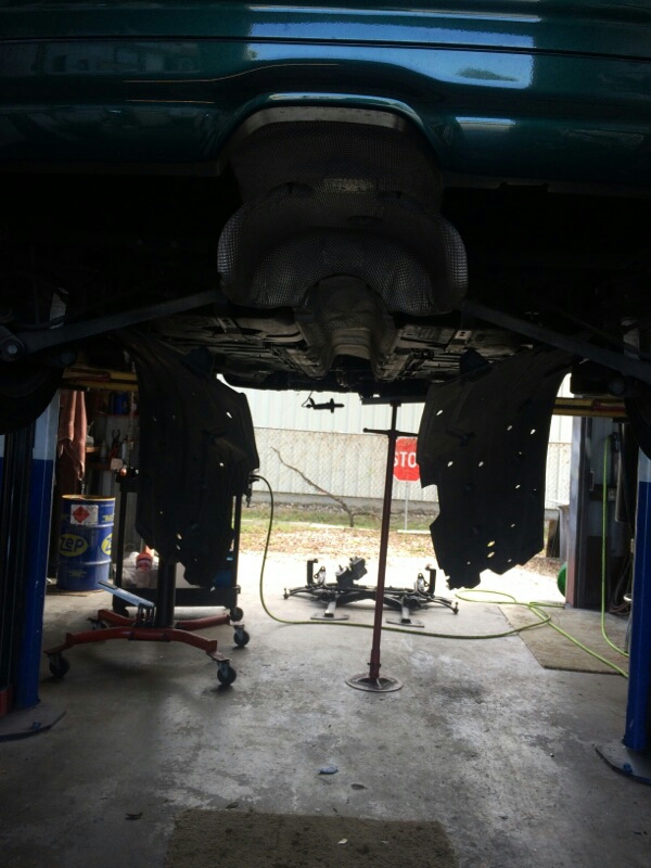

The disassembled mini. What a pain in the rear this must have been.
Attached Thumbnails Pics of my blown clutch-img_30411.jpg   Pics of my blown clutch-img_30441.jpg   Pics of my blown clutch-img_30421.jpg   Pics of my blown clutch-img_30401.jpg   Pics of my blown clutch-img_30451.jpg
