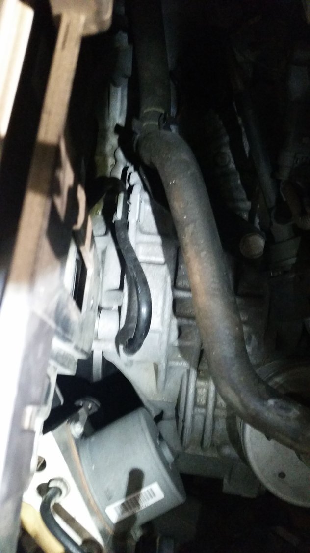

Can someone please
confirm this is a breather hose and not something I'm missing the connection for?
Old Jan 4, 2016 | 08:45 PM
Slave to Felines's Avatar
Slave to Felines
Posts: 2,064
Likes: 15
From: Silly-con Valley
It's a breather hose.
Old Jan 5, 2016 | 05:11 AM
Posts: 36,758
Likes: 2,548
Yes.
https://www.northamericanmotoring.co...-end-info.html
