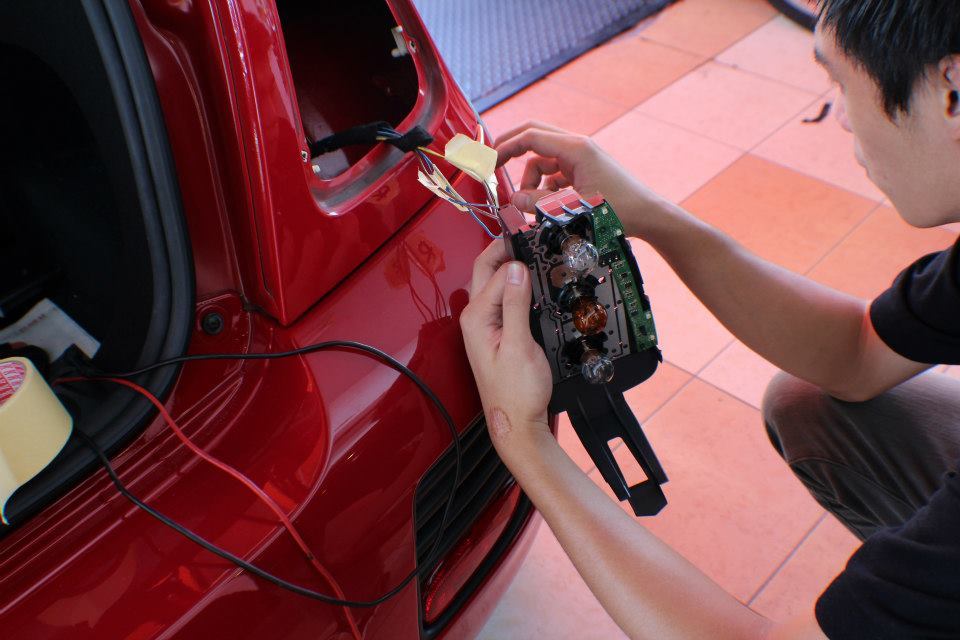

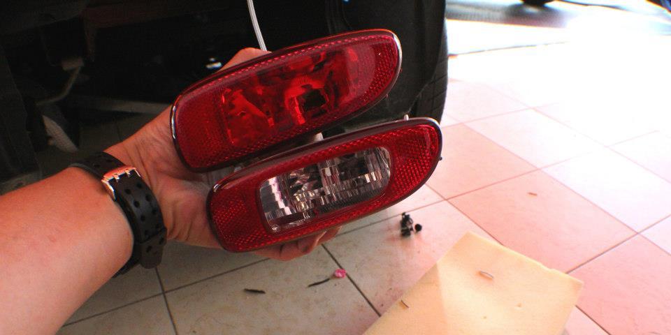

and some pictures of the black lines being retrofitted to a pre-LCI MCS
Size:  109.9 KBName:  Black%20Line.2_zpspewihkto.jpg
Size:  76.4 KBName:  Black%20Line.3_zps9o0dfu9l.jpg
Size:  112.2 KBName:  Reverse%20Light_zpswrumazsr.jpg
Old Jun 10, 2015 | 10:31 AM
Posts: 36,760
Likes: 2,549
Yes , they cut up the wiring harness then coded to maybe make them work, remember post LCI also configured in the LKM for the LCI light and the LCI also have the emergency braking light codes, which most likly does not work in the pre LCI LKM. Also they tapped / added the rear back up light as the back up light. Which would have to be added.
