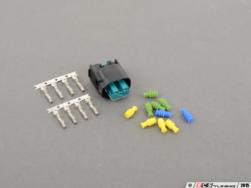

I’m having a problem finding rear fog - back up light plug socket for my Mini Cooper S R56 2009. I replaced the rear bumper with one from an LCI / 2012 which had different fog lights, the plug coming from the car doesn't match the plug on fog lights from the new LCI bumper. Does anyone know where to get the correct plug? so I could replace it and get these rear fog - back up light to work. Or does anyone have any better ideas?

I live in France, I can't find the connectors at scrapyards neither on Ebay. If only i could find the part number of the connector...

Thanks for your reply. This is the part number 7255922, I'm searching for the connectors going from the car to those fog lights

Hello, I finally found the connectors. https://www.ebay.fr/itm/GENUINE-BMW-....c100167.m2940
Now I have to find the Wiring diagram in order to fit all the wires. Does annyone know where to find the Wiring diagram for Mini Cooper s R56 LCI?

I will try to get that info for you. ON the wire part #s and pins.
Old Mar 15, 2021 | 11:40 AM
  #44
Posts: 36,719
Likes: 2,537
Hello,
Used use those pin connections and cut back the wire a little.
https://www.ecstuning.com/b-genuine-...g/61132359998/
