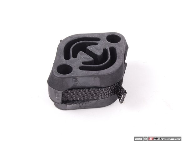

I have the same clunking noise, time to buy some exhaust hangers. There's a brace directly under the shifter and when you hit a bump just right the exhaust pipe clunks on that brace. Take a look at your exhaust hangers, there probably stretched out like mine. Cheapest place to get them is ECS Tuning.
Thanks! I'll look into that. Makes sense too, there's an aftermarket 3" exhaust on it too that probably makes for less room and more weight on the hangers. Thank you!

Exhaust hangers right here: 2 mid front and 2 rear.
18302753085
http://www.ecstuning.com/Search/SiteSearch/18302753085/ES40497/

Exhaust hangers right here: 2 mid front and 2 rear. 18302753085 http://www.ecstuning.com/Search/SiteSearch/18302753085/ES40497/
Excellent. Thank you!
