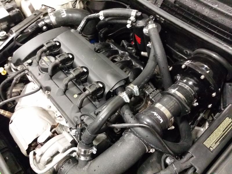

What does this hard JCW tube look like? Can you post a pic? I also just aquired a DOS inake after hearing what it sounds like in person.

This isn't my car, but its the same intake tube:
And ignore the catchcan with the hose going to the intake tube.

Here is my fix... It works great so far with the alta jcw hard pipe. I had to get back to the stock dv as jcw hard pipe wouldn't fit with gfb dv+. The best intake ever. The car sounds like a beast.
Attached Thumbnails DoS Intake Sliding Off... Need a clamp-jcw-alta-hard-pipe.jpg
