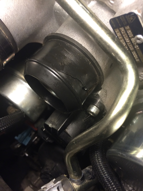

Anyone know if I purchase just this rubber spool piece on the turbo inlet? As you can see this one is damaged.

No, doesn't look like that part is sold individually from the turbo itself:
http://www.realoem.com/bmw/showparts...=11&fg=50&hl=1
What did drop on it to crack it ?

Thanks for the info. The damaged part is a black plastic spool that stayed on the inlet when I removed the inlet pipe, I think it just deteriorated from time, heat and oil.
+1 Moderately common
Check this part out:
It's a bit tricky to get on but its a very nice replacement
HERE is a link

If intake boot it cracked on the small gasket and the main boot has a crack ( seen it on mine before ), you will have to get the whole tube. Which when you replace will be fine and seal. Clean up the oil residue on the flange and they slide it on all the way.
13717555784 ribbed version N14 Cooper S .
http://www.ecstuning.com/Search/SiteSearch/13717555784/
And a new clamp for that turbo inlet connection , the old ones can bend from over clamping on / off all the time and the tube works it way off.
http://www.ecstuning.com/Search/SiteSearch/13717577548/ES35254/
