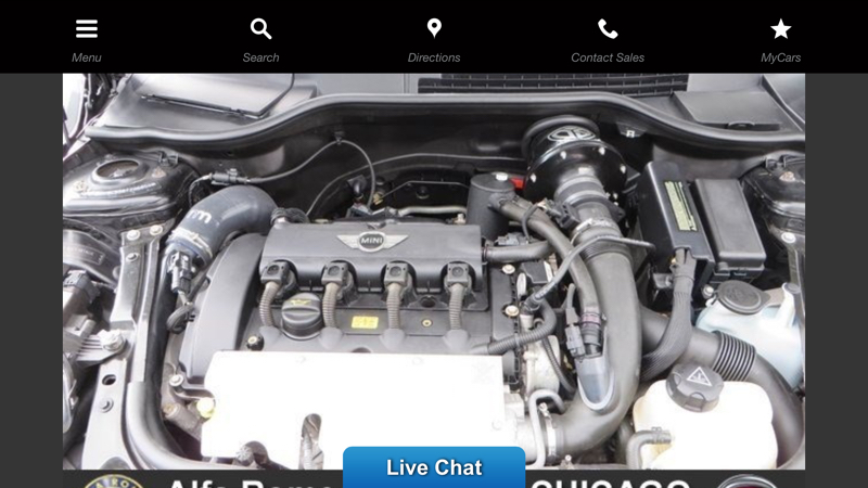

I also have the DoS (just got a JCW)
So I am hoping/wondering if all the
DoS CAI use long life cleanable
filters.
Because I have no idea how or where to
get paper cone filters, if applicable, that would fit in since the company is now defunct.

As for MAF sensors, yes that does happen. But it only happens with an improperly oiled filter. You don't really see brand new filters with too much oil, but I being a nervous person, still bad the filter a little bit to be sure.
As for your DoS intake, yes they are all lifelong filter. Just need cleaned every ~50k depending on your local atmospheric conditions.
