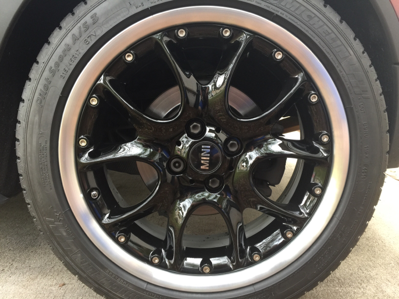

Finally resolved!! They gave me a new brake wear sensor and paid to have all my wheels refinished. No before pics, but I'm happy with the results and that they did the right thing and fixed their mistakes.
