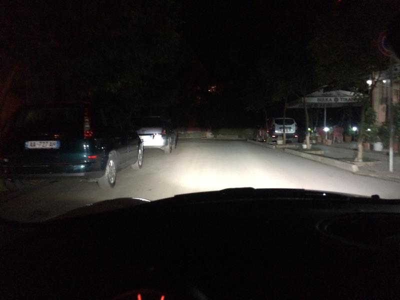

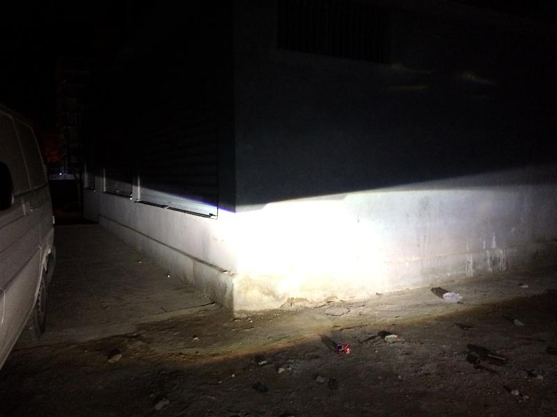

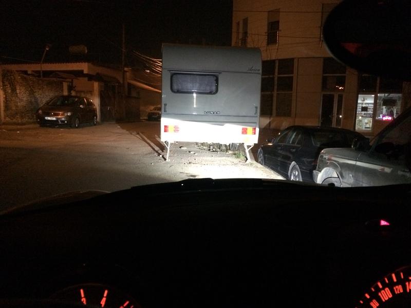

Hello guys.
I just wanted to share with you that i have installed Morimoto H1 projectors onto my Mini One D 2009 LHD. I did not cut anything. For opening the headlights i just used an hair dry and it was prety easy. I did had some problems only for mounting them, but it did installed good. Is not the perfect solution without cuting, but i was sadisfated with the results. Sorry that i did not take any photo of setup, but i can share only informations that H1 can be installed, and no cut is involted. This is also an experience for opening headlights.

Looks great, I want to retrofit my halogens to HIDs so badly...
