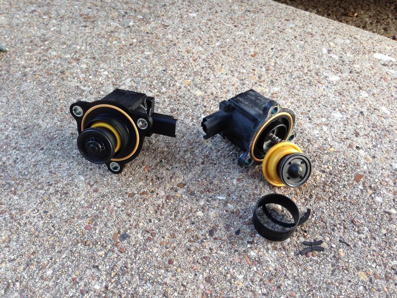

Well....Fixed mine today and it was not the diverter valve. I was playing with the vacuum lines at the turbo to see if I could diagnose a failed diverter valve diaphragm, without actually taking it off. I found that I had no vacuum at the wastegate dashpot. The wastegate is normally-closed by vacuum when the engine is not in a over-boost mode. So...no vacuum...the waste gate is open and...no boost. Followed the vac line back (Braille method from below) and, sure enough, the hose had popped off of its nipple on the vacuum box. All is well...zoom...zoom. I'm still surprised that this condition would bring up the yellow half-engine light but no CEL. I've been searching the forums all week and never saw this mentioned as a possible cause for a no boost condition. Nothing like being a pioneer. I will be putting in the ALTA spring.

New diverter valve in. Omg!!! Ms. Frizzle is so happy to be holding boost again! It took about an hour to do, I'm 6'4" working on a lowered MCS with no ramps. Back is killing me. Attached is a comparison of the new vs what I took off.
