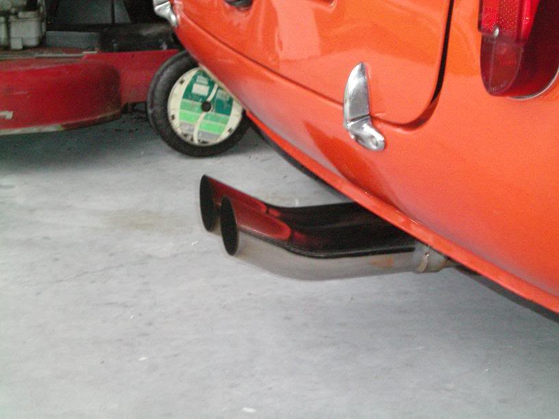

my 79 burbles with the best (but backfire indicates a BIG problem)
SO
find a classic Mini and adjust .. if necessary change to a 1275 with HIF-6, sport intake manifold, K&N cone, LCB to a stainless PlayMini backbox and twin DTM
