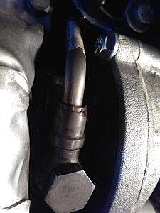

That is until we noticed oil leaking from the oil feed line on top of the turbo!! The crimp fitting I guess broke at some point during disassembly or re-assembly, I'm not sure which. Basically the pipe moves freely within the crimp that attaches to the banjo. It does this at the block side of the line as well. I feel like this must be something you have to replace each time you pull off the turbo, but maybe it just has to be handled very carefully.
Either way, looks like I will be pulling the turbo off for a second time after a new feed line comes in. I feel a flexible line with AN fittings would be better, but I have no idea where to source one or the parts to build one myself.
The feed is disconnected in the more zoomed out picture on top of the turbo.

This oil feed line appears to be a common problem. I've read that a couple of the forum vendors have new and improved versions available. ECS Tuning is the first one that comes to mind. There's gotta be others. You might search their web sites.
Congrats on getting it back together and running. One "do-over" isn't bad for a Mini first timer. I had more than my share.

I'm not surprised about it being common, it appears to be a poor design. I've done some more research and I think there's a couple shops in Los Angeles that can create a custom flex line with AN fittings.
