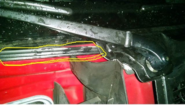

spent another hour today before it got dark and more rainy. and made it worse.. cant get them to fit together well at all now. (sure i'll fix it in the daylight , but damnit!!) ANYway, whats this seal piece at the bottom of the glass for? the new kit didn't come with it and it just seems in the way. any ideas? Replacing seal at bottom of windshield-ach3ayxl.jpg

never mind i got it! that bit fits better when rolled into the cowl and worked onto the windshield. Friggin pain in the asp. but it can be done!
