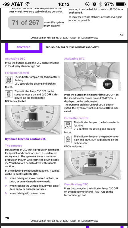

I got it with my 2013. It's a much needed option IMHO, with this past winter it literarily made the car much easier to drive when it was slick out. The base level DSC is way too intrusive on the slightest wheel spin. It cuts engine power so abruptly it causes the engine to buck.
It's not a replacement for a physical LSD, but it's better than nothing.
Attached Thumbnails Retrofitting DTC/ELDC?-image-2705496242.jpg
