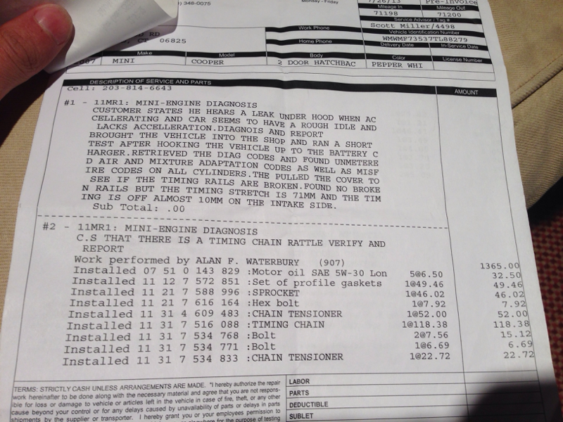

When was your timing chain replaced. When mine started going it threw random misfires 1-4 and fuel adaption errors. Just a thought
Sent from phone
In last 3000 miles tensioner was replaced. I assumed they did the chain too, as part of that service bulletin

micromini234's Avatar
micromini234
Joined: Jul 2011
Posts: 413
From: Connecticut
If just the tensioner was replaced, the chain probably wasn't replaced here's my diagnosis
Attached Thumbnails Carbon buildup codes of death? HPFP?-image-2689874347.jpg
Thanks for telling me that.
Seems like these misfire codes come up for almost anything wrong with the car.
Wait they replaced your sprocket? They didn't do that for me...?
Tried something else; run stage 2 map instead.
So far it drives fine but I hear a slight clanking noise at idle with hood open. No CEL, no codes at first but after an easy drive the P2a75 code is up. Still no CEL.
No cel, it must be mechanical. Could be one of your cam sprockets to where the chain jumped teeth on one sprocket causing misfiring. The overlapping could be the chain making that clanking noise at idle.
