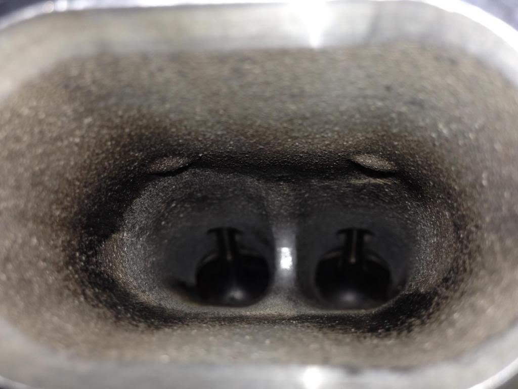

Seafoam will not do you any good, and water meth can only do so much. So don't go around thinking just because you have a water/meth doesn't mean you don't have to get your valves cleaned. Not speaking to anyone in particular, but it should be done. Buddy of mine has over 50k miles and never got his valves cleaned. Had Aquamist for for the life of the MINI and this is how the valves look still. Water meth is not bullet proof, but it'll help, to an extent.
Now he's performing just fine after I recommended he take his MINI to my buddy's shop to get it done. If you're over 40k, don't 2nd guess this kinda work...get it done.
I'm at 64k miles and I'll be getting it done again soon. If you don't want any issues, don't hesitate to get this service performed on your MINI.
