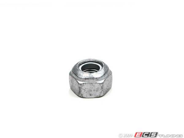

Top center nut: #3
http://www.ecstuning.com/Search/SiteSearch/31336764470/ES50822/

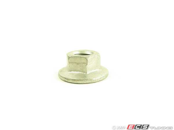

Collar nuts #2 , there for each strut. Replace them if they look bad or corroded.
http://www.ecstuning.com/Search/SiteSearch/31316769731/ES50047/
