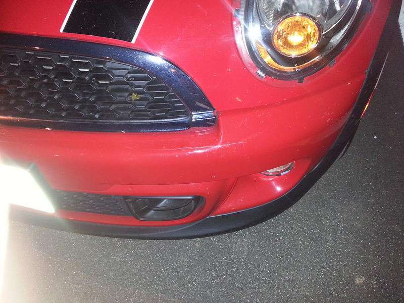

As you can guess from the title, I had a small encounter with a deer earlier tonight. The damage isn't bad, all things considered. The chrome ring around the driver's headlight is broken and popped off, there's some damage on the bumper, a small dent on the hood, and the trim around one of the ducts in the front bumper broke off as well.
I found the chrome ring for relatively cheap (<$25) but I can't find the trim piece for the vent. It looks like part of the intake or a duct that leads to the intercooler, on the driver's side as well, just next to the fog light.
Does anyone know the part number for the vent trim? I'm attaching pictures so you can see the damage and see what I'm asking about...

well i dont know the part number but i do those vents are meant for the front brakes not for the intercooler, so perhaps changing your search to that will give you better results.

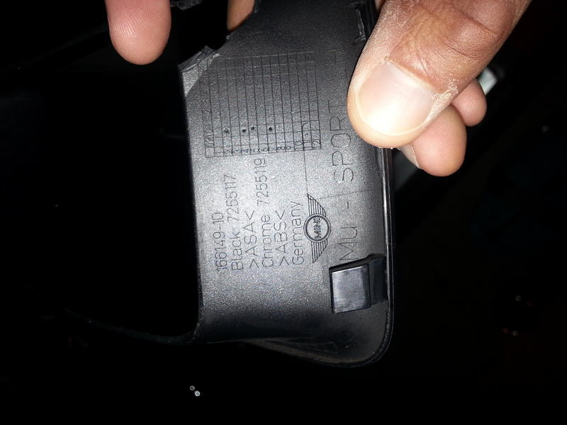

I did collect the missing pieces from the road before I left the scene, and I took a picture of the broken part I'm looking for, and there are numbers on it...I'm wondering if that's the part number?
And I think the deer lost, but it did manage to scurry away. I hit it at maybe 25-30 mph. I had just turned on to a street that leads out of my neighborhood, so I wasn't going very fast. I did manage to swerve a bit so I didn't hit it squarely, but I did see some fur flying... I also realized that it caused my driver's side fog lamp to stop working. I'm guessing the bulb is blown, because I don't see any other damage but I haven't had the chance to investigate it deeper. I'll look at it later today.
EDIT: That is a part of the part number. I found the piece I'm looking for. It was under the category of "vehicle trim" once I searched for the part number, I found it. Sadly, it's more expensive than the chrome ring for the headlamp...But all in all, I'm coming out of this with less than $100 in damage, so I shouldn't complain...

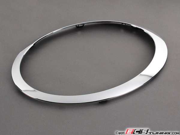

Headlight Trim Ring Chrome - Set ( If you want them to match "no pitting" since they are new )
http://www.ecstuning.com/Search/SiteSearch/51137149905KT/
If you just want the individuals:
Headlight Trim Ring Chrome - Driver ( Left )
http://www.ecstuning.com/Search/SiteSearch/51137149905/ES78211/
Headlight Trim Ring Chrome - Passenger ( Right )
http://www.ecstuning.com/Search/SiteSearch/51137149906/ES78212/
....or you could change it to the black line. (match the gloss black ducts )
http://www.ecstuning.com/Search/SiteSearch/51132254895KT/
Here is the duct parts: These are of course for 8/2010+ with the stock bumper brake intake ducts , Cooper S type bumper.
Brake Duct Frame Black - Left (driver ) Part # 51117255117
http://www.ecstuning.com/Search/SiteSearch/51117255117/
Brake Duct Frame Black - Right ( passenger ) Part # 51117255118
http://www.ecstuning.com/Search/SiteSearch/51117255118/
Here are the chrome ones just in case people need them.
Brake Duct Frame Chrome - Left (Driver) Part # 51117255119
http://www.ecstuning.com/Search/SiteSearch/51117255119/
Brake Duct Frame Chrome - Right ( Passenger ) Part # 51117255120
http://www.ecstuning.com/Search/SiteSearch/51117255120/
Check out the bumper and make sure the fog light or position light only is ok.

I was looking at it again, the fog lamp and head lamp are still aligned properly, but the hood is a little more crooked than I thought. I may have to get someone to see if they can realign it and pull the dent sooner than I originally expected...

Check the bracket on the fog light or position light and I would also inspect the bumper skin alignment. And #9 on the lower lip ok , they can sometimes crack on impact.
On the fog light there is a screws on the bottom and one on the top of the bracket, they can be aligned a little, but not much by those points.
Looks like you have the fog /position light, but there is also the position light only version. Either way check for the mounts to be cracked or broken. You will have to get behind the fender liner to check where these mount to back of the bumper skin.
#2 Front Fog Light With Position Light Part # 63172751295
http://www.ecstuning.com/Search/SiteSearch/63172751295/
OR
#1 Parking Light ( position light housing only ) Part # 63172751293
http://www.ecstuning.com/Search/SiteSearch/63172751293/
Good luck on the other repairs. Would be good to really inspect everything just to make sure there is no hidden damage.
