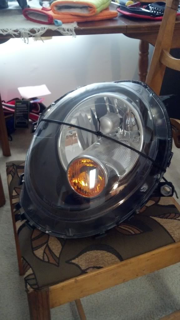

so yesterday i decided to take on a little project and redo my headlights. It was super simple. set my Oven at 225 and put my headlight in one at a time for about 4-6 minutes. pull it out and work on it for a little bit with a flat head screwdriver and put it back in for a few minutes. It took my to do this twice for each headlight and then I finally got them apart. stripped the aluminum coating with some windex. then painted away. I really really like the way they look and it wasn't hard to do at all. I highly recommend doing it.

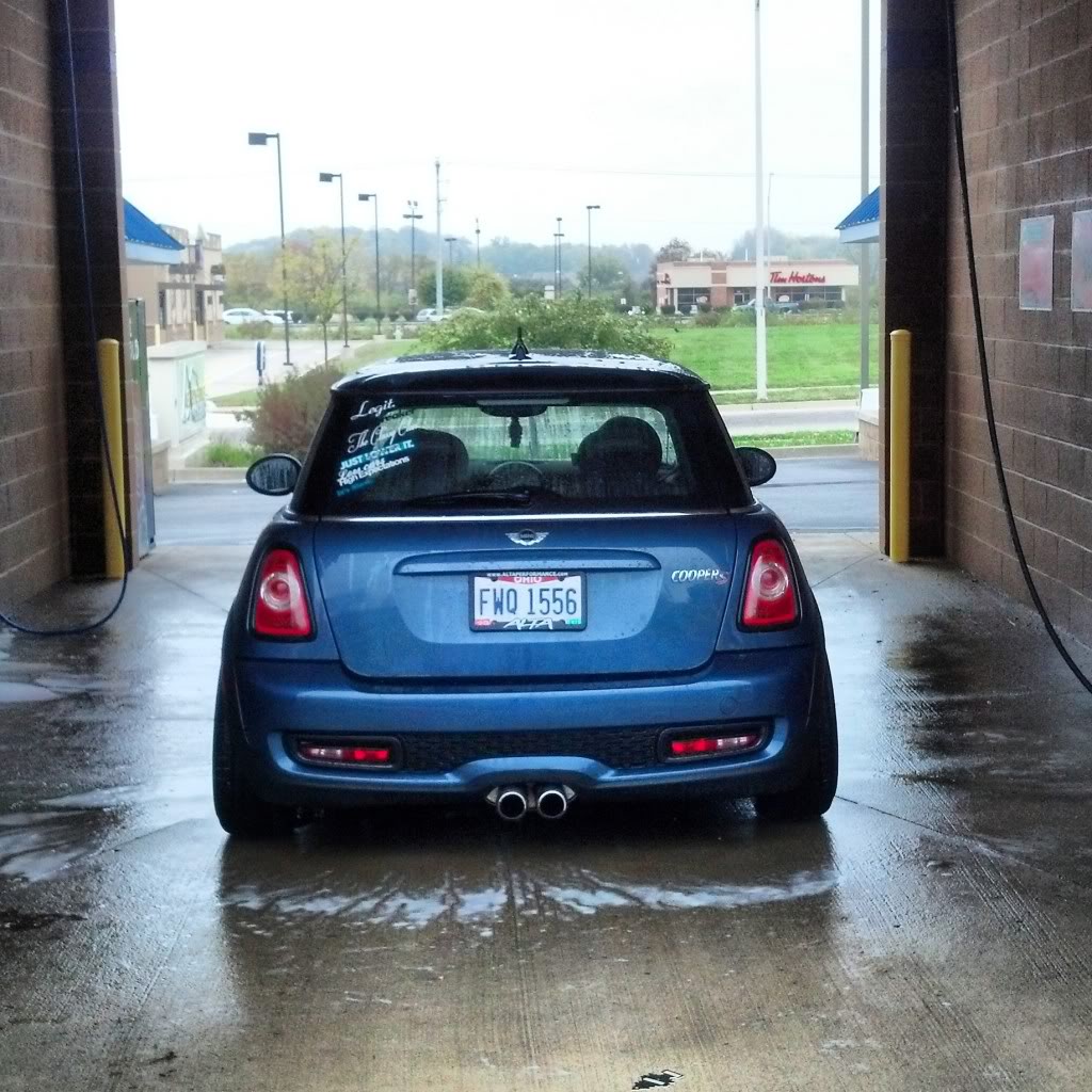

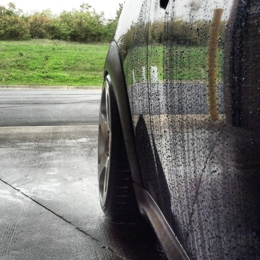

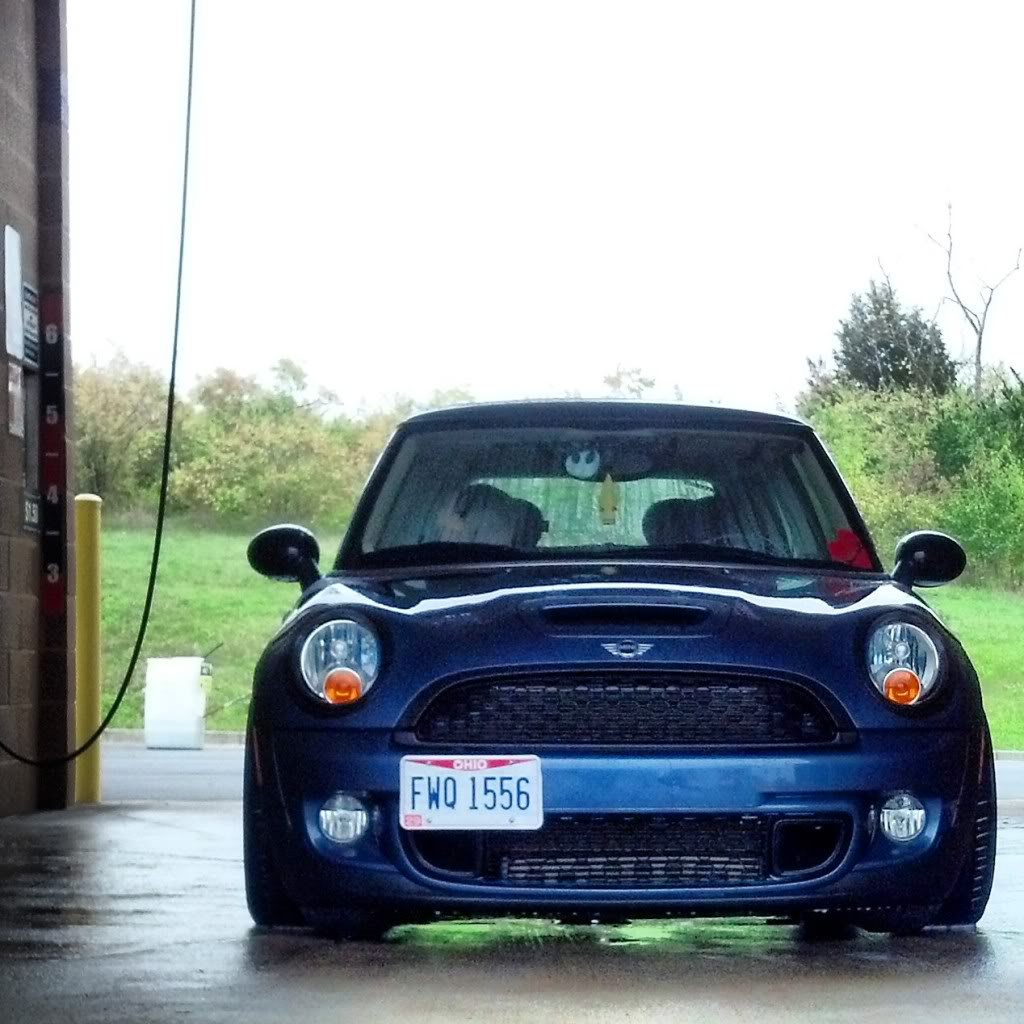

Some more pics to Show her off. Got a bath today\

Nice! What paint did you use? It's looks like it has some good depth to it.

Thanks! At first i used some high temperature black paint used for grills and things of that sort. well it looked like crap and all i had lying around was a can of plastidip so i put a few coats of that on and it looked fantastic so i put a about 4-5 light coats of that on and i couldn't be happier with the results.

Best thing you can do for those halogens, short of a retrofit. I used PD on mine too.

Your headlights came out great! I'm going to be doing the same thing to my halogens in the spring.
Your car looks amazing....love the stance.
