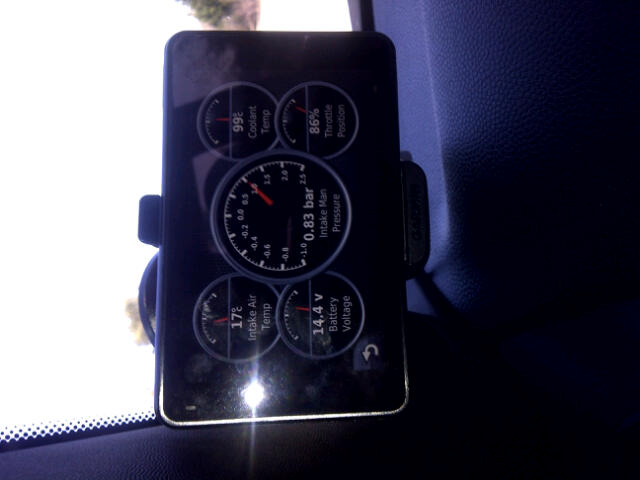

The waste gate rattle is a bit more ringy than a tak tak sound - that I suspect is injector noise.
As for the temp guage... There are options. Scan guage for one, or uf you are as perpetually lost as I am, pick up a late model Garmin and add the EcoRoute module. It plugs into the OBD II port and gives a display that is fairly customisable, and doubles as a GPS! See attached image - I have mine in Metric, but you can go old school Imperial if you wish...
E
