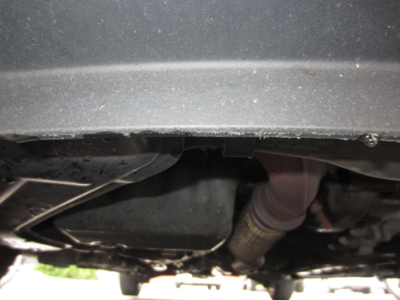

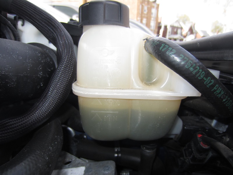

Coolant Loss II - 4/19/2013
So I topped off in the chilly cold last night to here:
and here it is today (less than 1 mile driven, car not even cold):
Seems like I've got a problem?

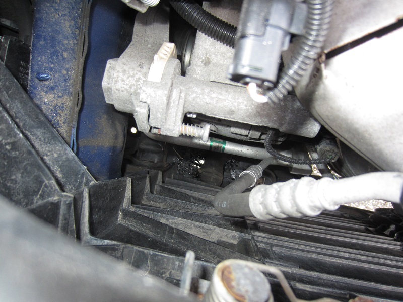

Looks like the leak is on the passenger side: I've got some droplets on the lip as well as some on the plastic undertray beneath it. No event for me this weekend. Not sure at this point where the leak has been sprung
front facing back of the car:
back facing towards:
i let the car run a little, and oddly enough the expansion tank started filling, and no sign of increased dripping, anything.... thoughts?

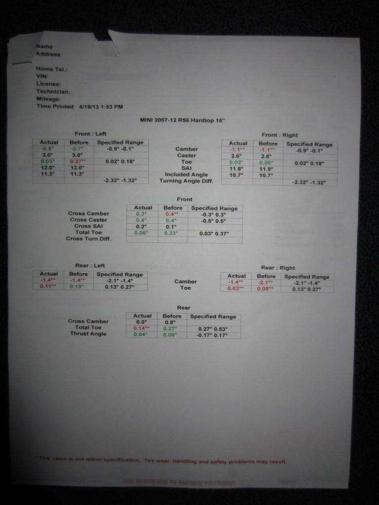

Post Camber Mod Alignment - 4/19/2013
Aside from the coolant loss issues, I did get the car realigned - basically I asked for max camber in the front, minimum camber in the rear, and close to 0 toe all around. This is what I got:
Not too bad. Looks like the camber mod netted me about -0.2 degrees of camber from both sides - more or less what I expected. I was informed the car hit a really bad pothole on the pass side earlier in the life of the car - probably why the caster is off in the front right.
Unfortunately, I won't be able to use it, since I can't pinpoint where this coolant leak is coming from...
https://www.northamericanmotoring.co...ml#post3723237

took it to a local shop that ran a pressure test (didnt charge a dime for it) - it is the radiator and/or radiator hose that's causing the leak

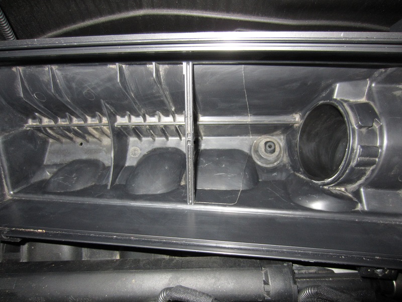

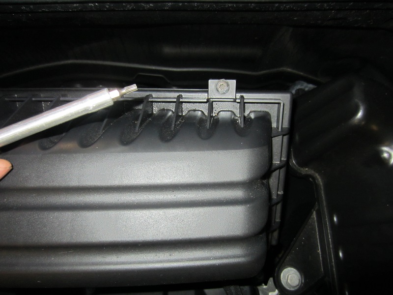

Air Filter Install - 4/20/2013
Very very simple install, but I'm trying to be committed in documenting everything I'm doing with the car:
K&N Filter PN #33-2386:

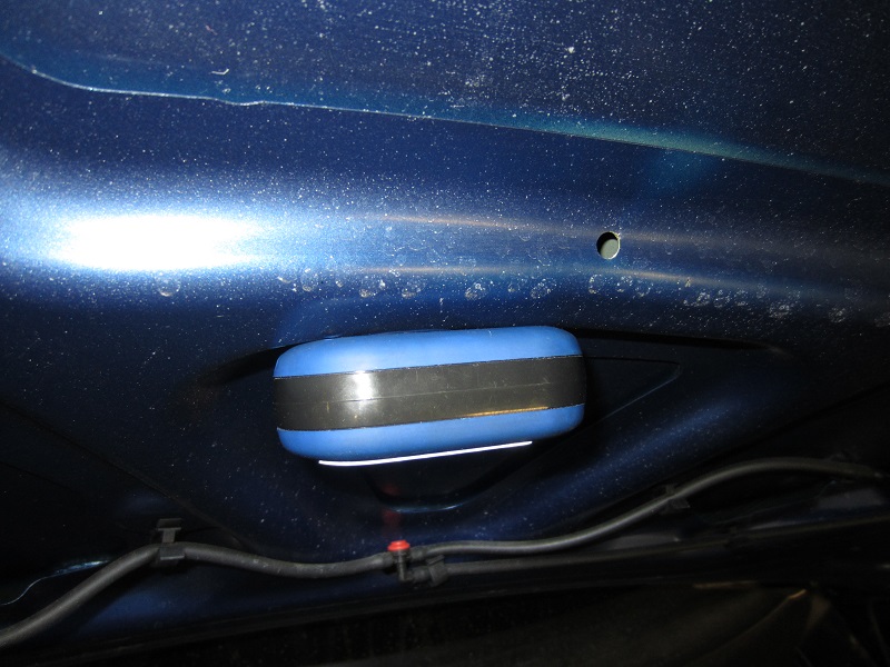

Tool needed for removing the air filter is a little atypical, but fortunately I had it. One tip - you only need to screw the screws out of the bottom part of the housing, and the screws will actually stay in the top portion - no need to worry about them falling out or anything. This is for an 08 base though, so may be different depending on the particular model. Afterwards, all you need to do is replace the top portion of the housing, align the screws, and you're all set.
I've got about five of these flashlights from Harbor Freight (like $3 each!) - it's got many LEDs on the face side, and a single led on the other side - also has a hook and a magnet on the back, and takes triple A batteries! Love these flashlights
Oddly, the K&N filter is much shorter than the OEM/Wix version but it fits:
Wiped down the housing:
New filter in!
Honestly, I couldn't tell a difference with it in, and actually completely forgot I installed it. Probably not any increase in HP - you'd probably only see a difference swapping the entire intake system out. Regardless, happy with the install etc.
