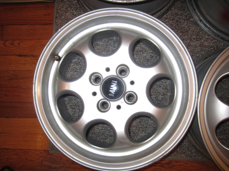

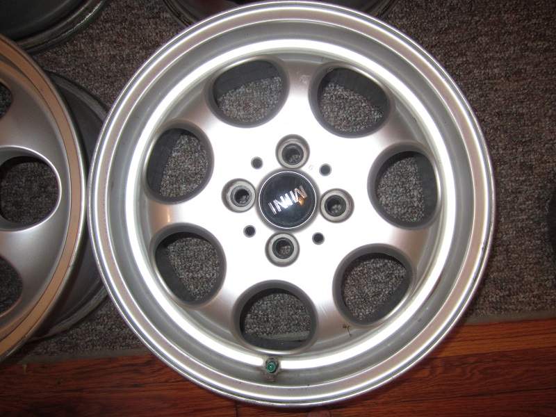

New Wheels - 5/20/2013
Judging by what many of the competitive HS Mini Coopers were running, I made up my mind to downsize to the 15x5.5 R81 Imolas, or "Holeys" as they're called. This is the 7 hole OEM wheel from Mini. I was a little on and off about pulling the trigger, but through a lot hunting on eBay I was able to get a killer deal on a set of four. No TPMS though -
One of them's got a decent amount of curb rash, but overall very happy with the condition of them, pretty clean I think.
The backs of them were another story though - brake dust was CAKED on and I wasn't sure I'd be able to get it off.. decided to try out a brake dust remover that got some pretty good reviews on amazon:
MOTHERS 05924 Foaming Wheel & Tire Cleaner - 24 oz : Amazon.com : Automotive MOTHERS 05924 Foaming Wheel & Tire Cleaner - 24 oz : Amazon.com : Automotive
Amazon.com: Mothers Detail Brush Set - 2 Pack: Automotive Amazon.com: Mothers Detail Brush Set - 2 Pack: Automotive
and I was happily able to get most of it off - wheels look fantastic now.

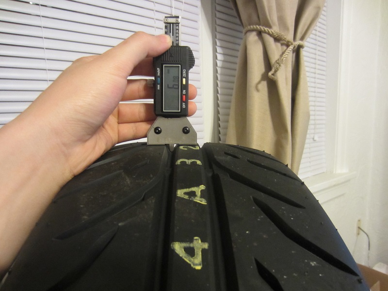

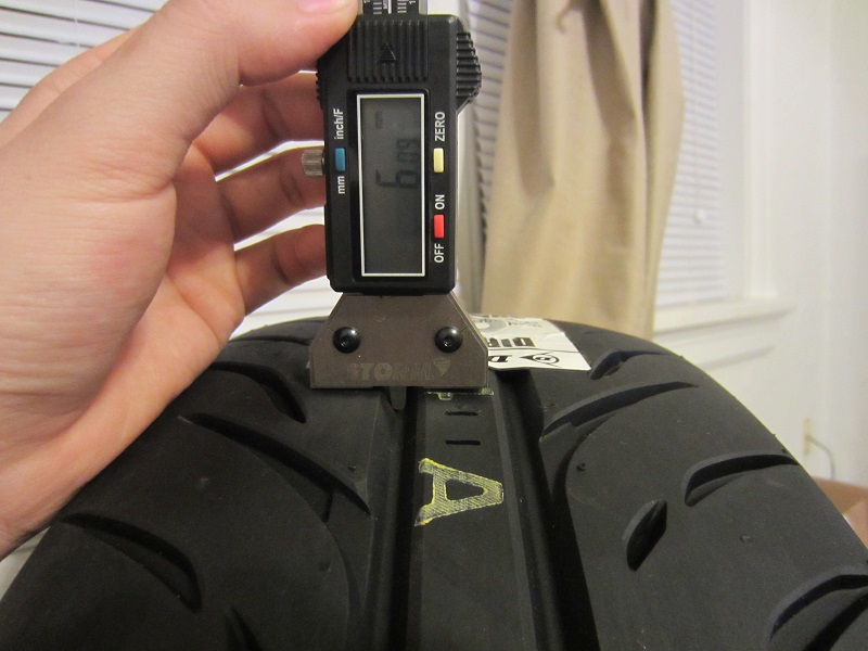

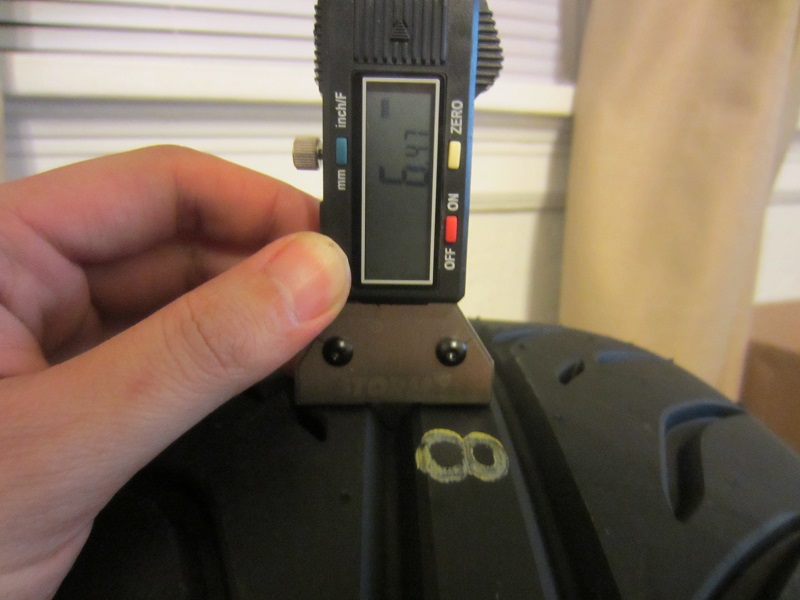

New Tires Dunlop ZII - 5/21/2013
Tires arrived today from Tire Rack! Decided to go with the ZII's over the Rivals in case there was ever a rainy event - overall I think these tires will last a lot longer without sacrificing too much grip compared to the rivals. Looking forward to getting them mounted and testing them out this weekend!

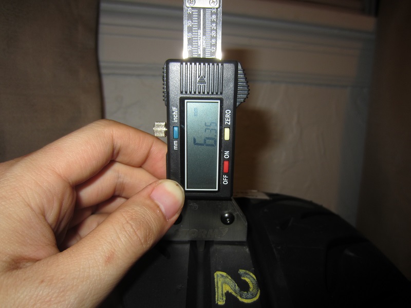

They all come with around 6-6.5mm of tread, so right about 8/32nds as advertised. The ZI's came with 1mm or 2 more, but hopefully these tires will last as long. I've read they generate quite a bit of road noise on the highway that the ZI's didn't, so I'll be curious to see how it goes.

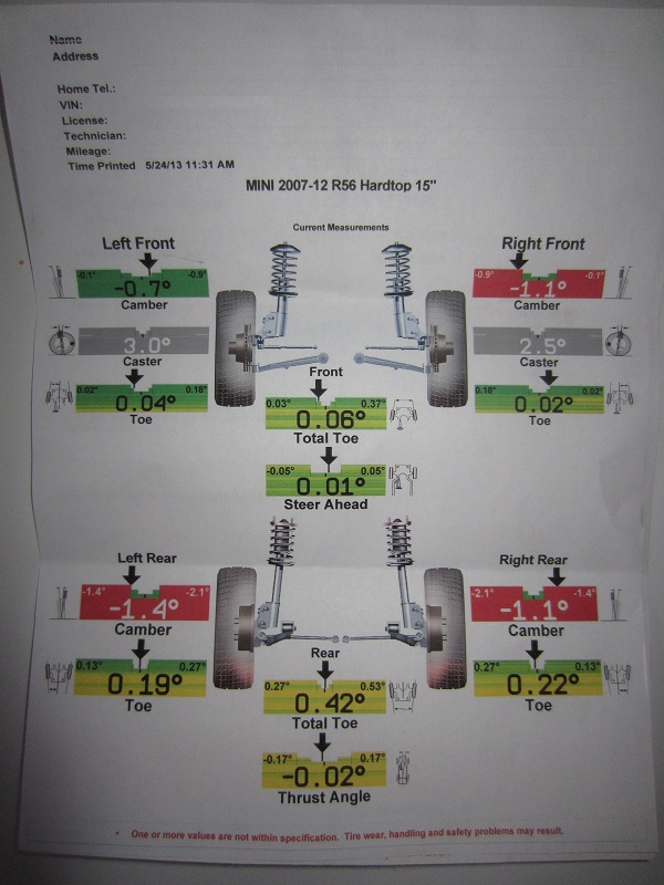

updated alignment as of today:
not too bad, a little less negative camber out of the rear, toes a little crazy still, but things look okay overall - these are on winter tires though, so there's a lot that can change when the zii's go on!

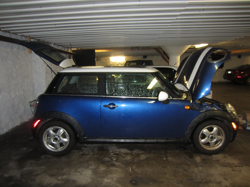

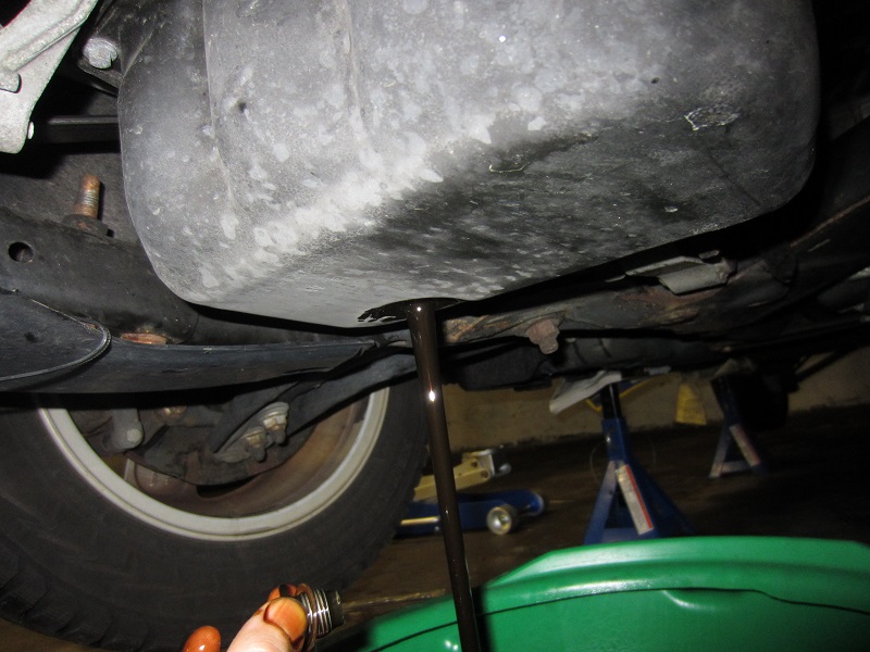

Oil & Trans Fluid Change - 05/27/2013
Finally got a chance today to do the engine oil and trans fluid. Very straight forward, and found in a number of good write-ups on the web. I'll post some pics and a very simple step by step as I remember it.
Oil Change
- I used a 8mm hex to unscrew and drain the oil, which was at the bottom of the oil pan. I'm changing at about 5k miles, from GC 0w-30 to Amsoil SSO 0w-30.

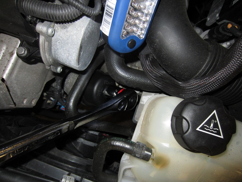

- Then used a 24mm socket to undo the oil filter. This was a very messy step - I'll have to do better in keeping the oil filter housing more upright for the next time.
- I replaced the oil filter & the o-ring and put the housing back on - just to about hand tight.

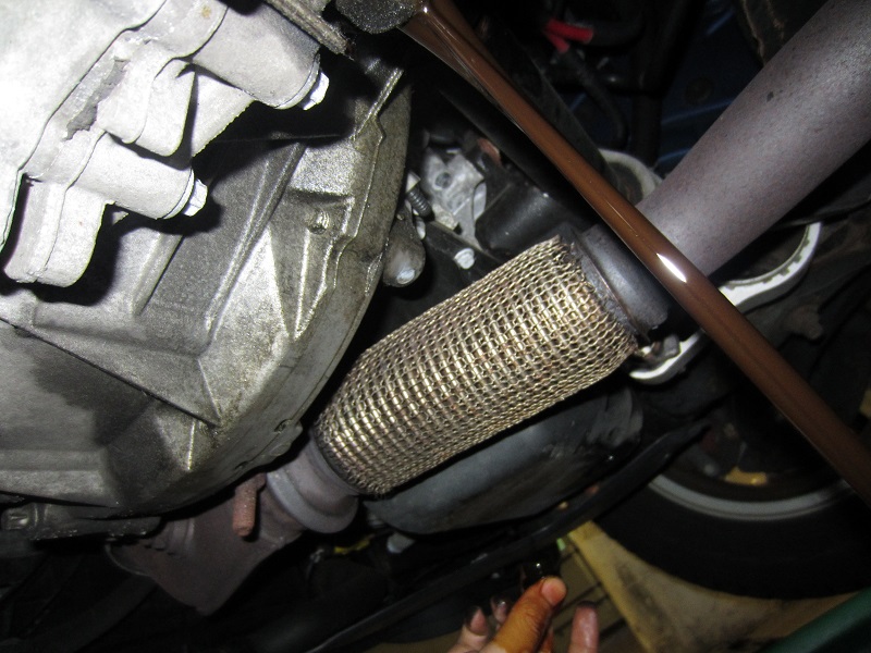

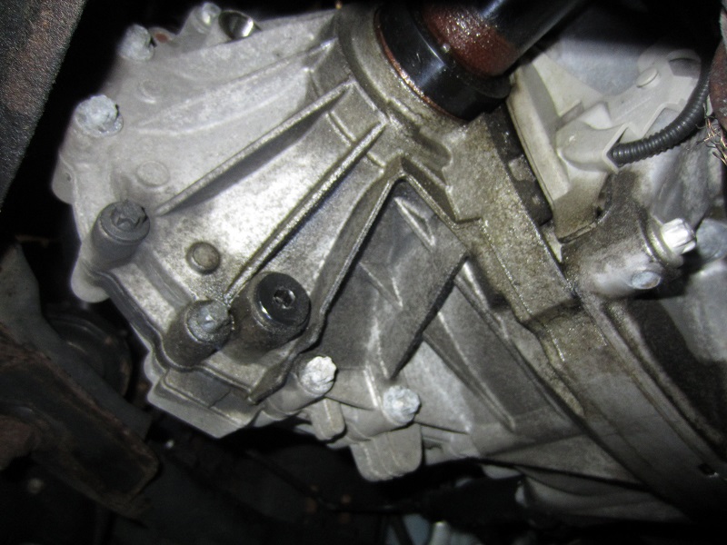

Transmission Fluid
- I never bought the whole "lifetime fluid" thing. I had been told by the dealer that changing the trans fluid would require dropping the front subframe (!) which I immediately found out online was not to be true. It was the same standard fill and drain plug as I've seen with most any other car, and probably one of the easiest to get to/do of all!
- Here's a shot of the trans with drain plug still in and fill plug already out. Both used 8mm hex sockets, and were very easy to break, despite not having been opened/changed in 91,250 miles
- Drain plug from the trans fluid
- Impressively, not any wear metals/shavings etc etc on the drain plug - just that very dirty oil

- I used a handpump to pump oil from the bottle into the fill plug after closing the drain plug back up. I pumped until fluid started coming back out of the fill plug, and then I closed everything back up, just to hand tight specs.
Impressions
- Both the trans and the engine seem to be marginally smoother - the transmission a little more so, as I'd expect. I'll probably follow a 15,000 mile interval for the trans, and a 5k one for the engine. I'd normally go 10 for the engine but I am auto-xing the Mini a LOT so these intervals should work fine

barring the potential severe thunderstorm scheduled for sunday, i'll be heading out for the 4th event in the Mini. I was getting some severe scrub at my 3rd event on my new wheel/tire setup, so I'll be running some different tire psis as recommended.
195/55 might just be too much for the 5.5" width wheels, so I'm hoping bumping the psis up will help - I ran around 38-40psi hot in the last event, may try upping that to 40/40 cold and go from there.
Old Jun 7, 2013 | 09:56 AM
  #100
Slave to Felines's Avatar
Slave to Felines
Posts: 2,064
Likes: 15
From: Silly-con Valley
195 is not too wide for 5.5" wheels. In fact, 205/50-15 is a standard fitment for a number of older Porsches running 5.5s.
Messing with tire pressures is definitely a good thing to try next. It is possible that raising them or lowering them will help, depending on where in the pressure vs. grip curve they are. Depending on exactly what is happening, tweaking any suspension adjustments you can may help as well.
You can always drive around the problem. Often not the fastest way to go, but it can work reasonably well. Drive really deep into the corner and have the wheel as straight as you can by the time you start really feeding in the throttle.
