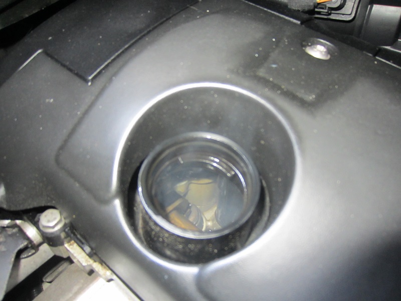

Also, has anyone ever noticed "steam" inside the dipstick tube and oil fill after the car has been run?

Some steam in the engine is probably normal. Oil accumulates water, because water is one of the products of burning gasoline. When water gets warm, it turns to steam. That's one of the reasons we really want to get the engine all the way up to operating temp--though it's not quite as critical a process as for, say, my wife's aircooled beast.
Lots and lots of steam would probably mean that there is extra water making its way into the combustion chambers, or into the oil passages. If your car has a "mist" system, it could be spraying a water/methanol mixture into the intake to help bring air temps down and try to clean oil residue off the valves. (Note: Those would generally only be an issue with the S models, looks like yours is not an S.) Or it could be that coolant is making its way in--and that would be bad news.
Does the steam smell sweet? If so, it is coolant and you need to find where it's coming from. In other cars, I'd say a head gasket, but there are some that have oil coolers that are cooled by the car's coolant. (Sorry for the wording there.) Seals in that can fail, mixing your oil and coolant. Not sure if our cars have that or not.
Any scum or cheese in your radiator overflow tank, or anywhere else in the cooling system that you can find?

As far as the steam goes, I'm not sure what it is - I tried to avoid inhaling it when I took a look. I was thinking it could be some form of coolant etc., but I didnt catch any residue from what I could see in the oil. Still possible, just haven't seen it yet. Car has never had it's water pump done, so may not be a bad idea.

pic of steaming:
- spoke with the dealer/service department, as well as original owner etc. this is regarded as normal

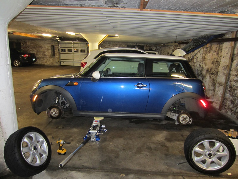

getting ready for tomorrow! first time autocrossing in the mini
