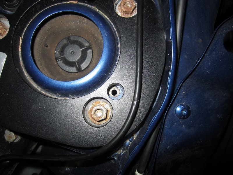

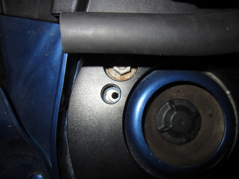

Any word on whether these white things are the plastic pins guys? Near the lower right bolt in the first pic and the upper left one in the right? pull those out and then loosen bolts, push, tighten down?

I believe that's the pin.
http://www.minicooperspeed.com/minic...er-adjustment/
- andrew

And, yes, those white pins in the holes of the M7 plates are the ones you pull. Then loosen the 3 nuts on the top, jack the car up just enough to allow you to push the top of the strut towards the engine and while holding the strut in place, tighten one of the nuts. That is just so the strut doesn't move when you tighten the other two nuts. Remember you will need a wheel alignment for toe-in. If you can do it yourself, you will need to turn the tie rod in by 1/2 turn on each side. That will get it back to approximently the same place it was before you made the camber change. If you don't adjust the toe-in you will have too much toe-in and lose the advantage the camber change gave you.
As Charlie said...Great to have another MINI out there in the autocross world

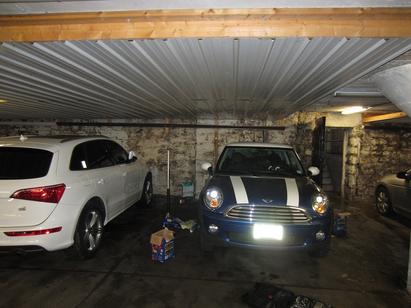

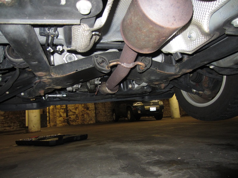

Under the Car - 4/11/2013
Finally jacked up the car and put it on stands today to get a good look at everything underneath - I'd say the car is fairly clean given its mileage - few spots of rust here and there, but more or less what I expected. Kind of funny how close the stands ended up being together. I'd say the chassis is fairly stiff too, a little stiffer than I expected.

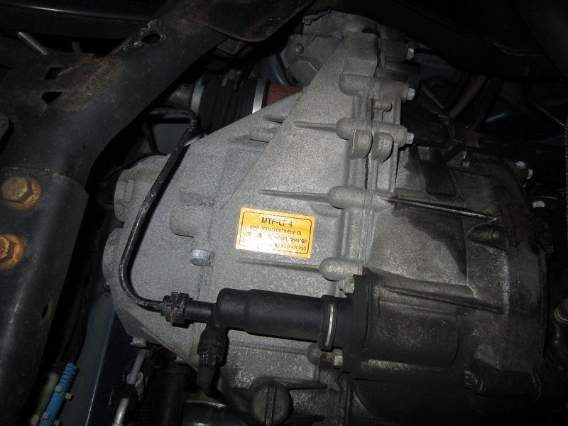

Trans with "lifetime" fluid sticker (pfft):

TLDR of the post above:
Ignore all I said except for the "missing" bolts in the trans - are they missing???

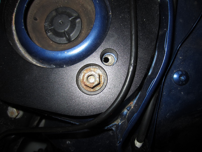

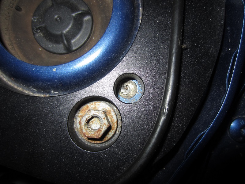

(1) I got the car lifted up (previous post) and loosened the strut tower bolts.
(2) I actually did screw a screw into the plastic pin - I tried it the other way the second time and it basically wouldn't work.
I personally ended up tearing the pin the first time, which initially I panicked about:
Until I realized it just poked through:
^ This picture is pretty good for showing you where the position at least initially was.
(3) Push the entire strut assembly towards the center of the car. It moves surprisingly easily. As someone recommended, I began bolting down one side before letting go. I did not use a torque wrench, I just tightened a good amount and I'll retorque it later after the car's been driven around a little. I think especially in my case, the STD may help "equalize" the pressure on the strut tower.
After:

Transmission "missing" bolt regarded as normal, not missing.
