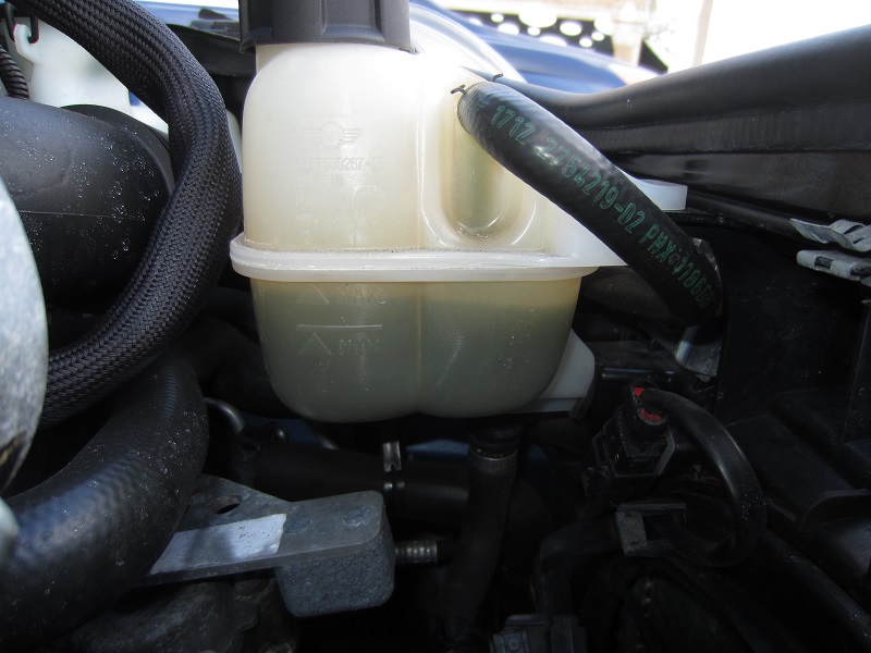

Had dialogue going about some coolant loss in another thread but brought it here. Still a mystery what's going on. I noticed some coolant missing last night, to my alarm. I thought perhaps it was because it was just cold (wasn't THAT cold).

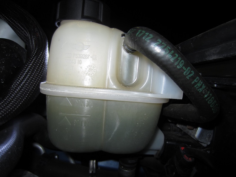

So, I decided to top off:

The next morning, I drove the car about 50 yards to get the alignment done, which I then picked up later in the afternoon. Less than 1 mile driven, and found:
I understand there's some fluctuation in the overflow tank res, but I thought it would be going the opposite way - It's full on ice cold, so maybe a little higher at any other point - this is the opposite. Now looking at the front of the car from the bottom, I found some coolant on the lip - I'd have to think the leak is somewhere right there in the front:
