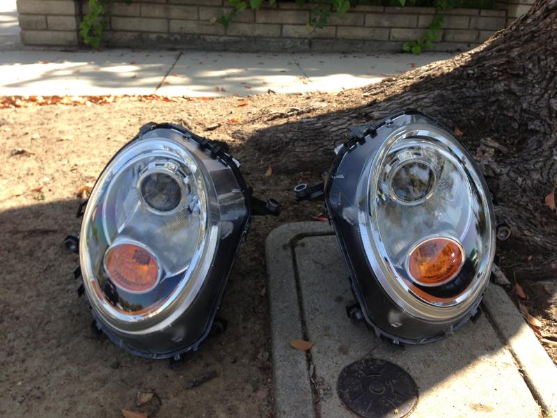

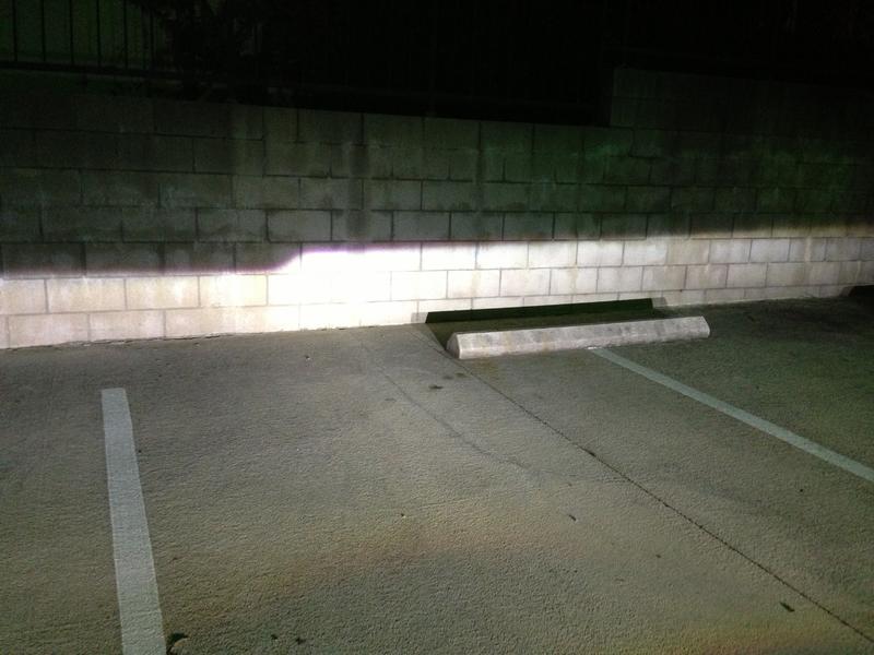

TRS HID retorfit
Damn.....I love the color and cutoff
Attached Thumbnails TRS HID retorfit-329.jpg   TRS HID retorfit-333.jpg   TRS HID retorfit-345.jpg

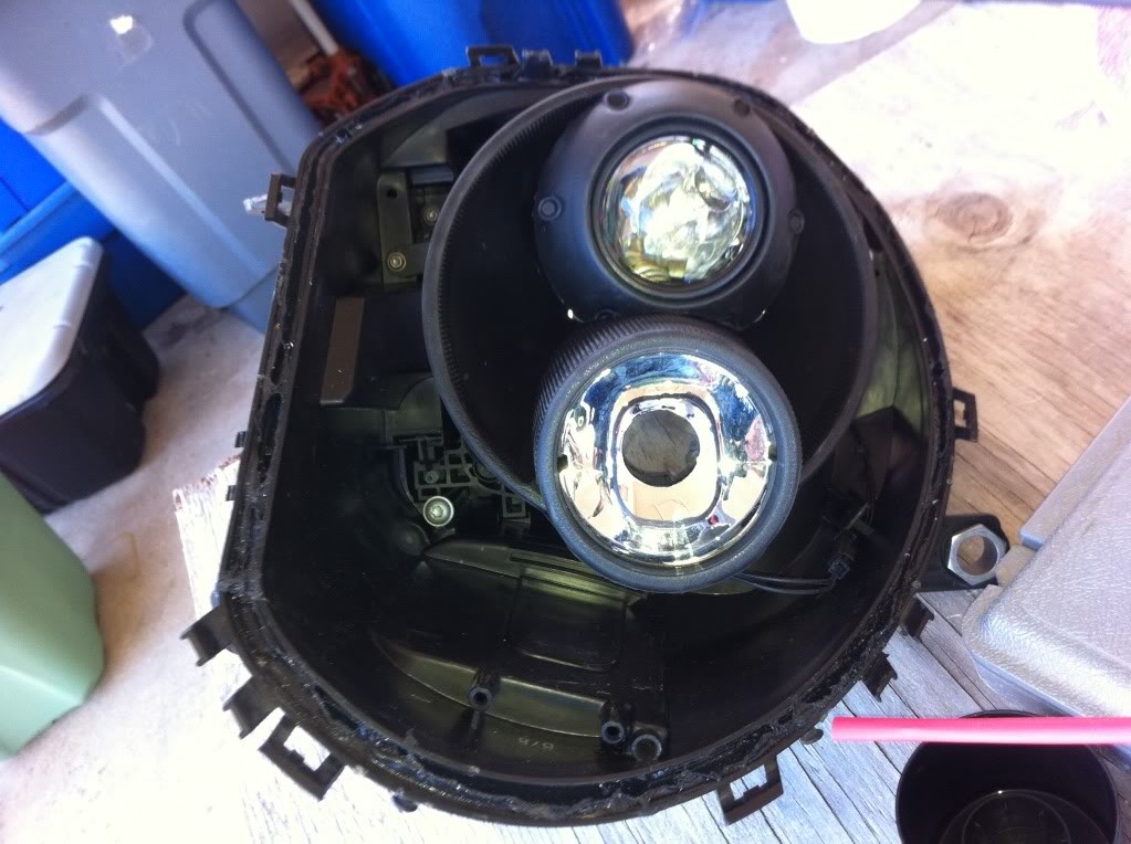

They look nice, what did you secure the projectors to the housing with?
Sean
Sean
I was able to secure the projectors using J-B SteelStik.
Attached Thumbnails TRS HID retorfit-photo-1-.jpg   TRS HID retorfit-photo.jpg   TRS HID retorfit-photo-2-.jpg

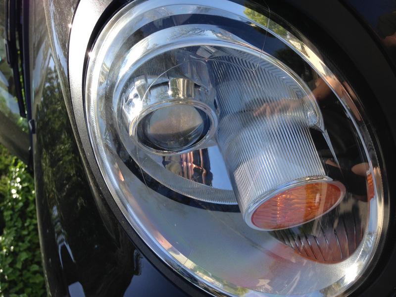

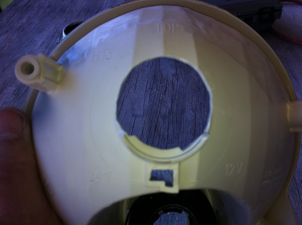

Old Mar 28, 2013 | 08:00 AM
yetti96's Avatar
yetti96
Joined: Jan 2010
Posts: 3,031
From: Ave Maria, FL
I secured mine with the locking nut on the back of the projector. I also dremeled less than the OP did.
Here is before more cutting...
The first time I did these I used a smaller shroud, I have a larger one that covers more now.
Can you show us a picture of the locking nut on the back please?
