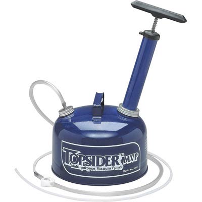

I bought that item few months ago and today I decided to change oil with that. but... I pumped about 30-40 times and place the tube in the dipstick hole and it sucked up only few and stopped. I think air leaks everytime I pump.. I checked everything but there is nothing wrong...anybody has same problem?

Yep. Exact same problem. Poor quality fit on the screw-on caps, very light construction that bends easily. It never worked satisfactorily. They must have been made better years ago to earn the reputation they have ... Make that HAD.

Try warranty for a replacement. Mine works fine.

how many times do you pump? as manual says 30-40 times, which I did.
it works only few seconds.. and stop sucking up.. How long does it go?

30 pumps drained almost all of it. Just had to pump some more to get the last of it. The vacuum runs out quickly sucking air.

Same here, do the 30 pumps, then i add another 10 pumps or so near the end of the change to build the vacuum back up to get the last bits.

I had a similar problem this weekend. The first 2 or three times that I had used it it worked like a charm. This weekend was a bit cool about 46 degres F. I noticed that I could not develop suction. It should be perfect at about 35 pumps. So, it had to be the sealing of the rubber gaskets on one of the fittings or the other. It was, the large gasket, below the pump itself had got in the wrong location. It must be set up so that it goes against the can's metal. I think they made the diameters a little too small, and the gaskets have a tendency to move . Check this very carefully. On each spout, the large and the small, a rubber seal must align on its rim when screwing on the fittings. Once I sorted this out, it worked well.
I've been meaning to nip the end of the thin tube to make sure that a flat end can't seal itself off by pressing against a flat surface, either the bottom of the oil pan or a side wall. Better to have a tiny bit left behind. Remember that the oil itself and the filter are designed to suspend particles. I think it's doing a fine job, if you can get the seals to be air-tight.
