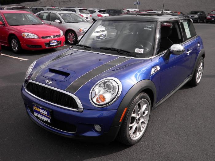

Hi everyone, im currently in the market for a mini, i have been interested in them for years and finally decided to go for it, i found an 07 mini cooper s that i think is perfect. but i don't know what im jumping into, Ive had vw and other Japanese based cars but this is something totally different and want others opinions on the subject of minis, ive tried doing research on there issues which is not as easy as one would think. i just am unsure of what im getting my self into. Attached is the one im looking at its an 07 with 36k on it.
I agree...nice looking ride with low miles.

Not a bad deal, there asking $19k, its got the the cold weather and convienance package, black leather interior, 6speed manual, and the wheels i adore. it says its equipped with run flats but im unsure of that. i haven't driven the car yet seeing how its 5 states away.... but it is exactly what im looking for in a mini.

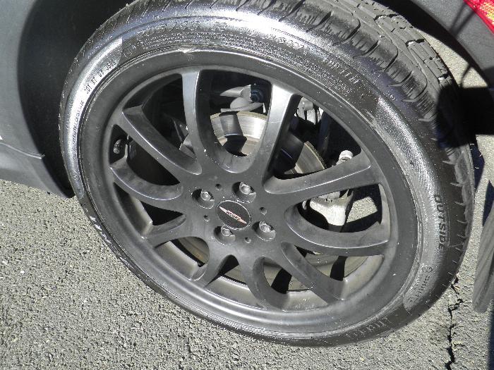

well i found a 07 cooper s here in my area, its white, has 64k on it and i test drove it today they want 16k for it, i dont think thats too bad, only thing i noticed it made some racket when he started it up before we left... i dont know but it was an awesome test drive. other issue is it has black wheels on it that the center caps say jcw but dont think there real.
Nvm i found a link for the wheels

The white mini S you found for $16k looks like a very nice car. Looks to me that the black wheels are stock S wheels painted or power coated black from the factory or after-market ( not sure which one). Does it come with a warranty? Is there someone that can check out the noise in the engine for you? I'd want to understand if it sounds normal or not.
