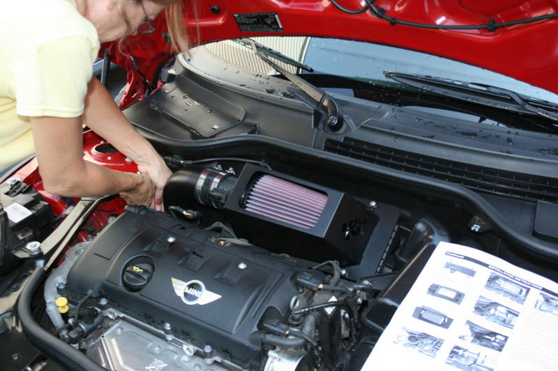

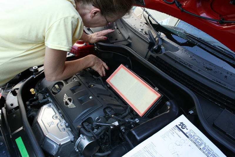

Just installed the K&N 69-2005TTK CAI for our '07 MINI Cooper. Installation took less than 30 minutes. Will update MPG numbers later.

Is the bottom of that air box connected to a fresh air duct from the front of the vehicle? I assume that's how stock is. Sorry i have an S. Looks similar to mine. And mine is open at the top like so and is definitely a cold air intake

Ducting
Yes. This setup replaces the top of the airfilter box, the filter, and the ducting that goes to the throttle body; the rest is factory.

Yeah but is the bottom of the box have a duct connected to it from the front of the car (fresh air supply) just curious. If so then it is a cold air intake
