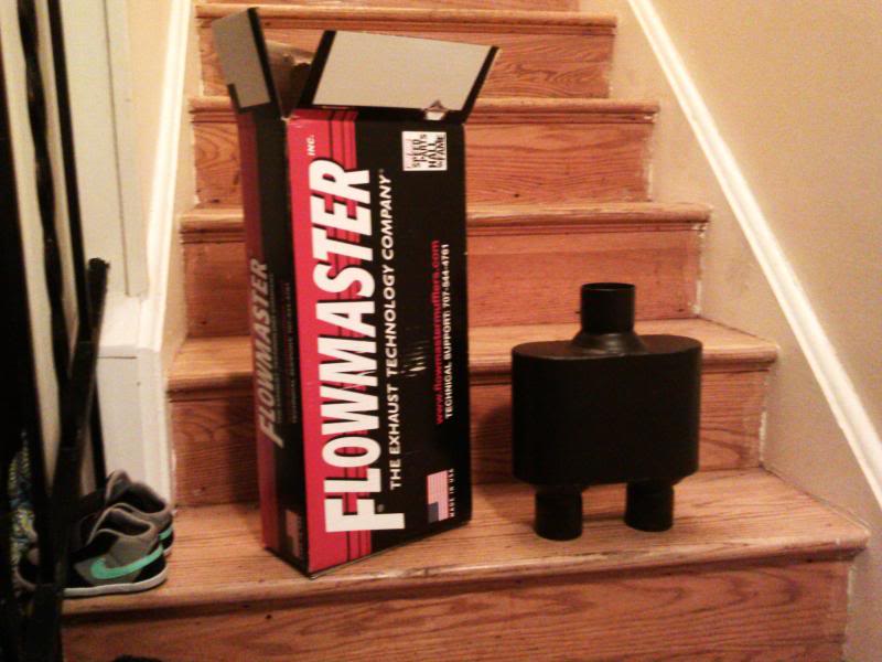

Hi guys just recently pieced together a custom exhaust system on my '11 MCS, used 2.5" machine bent piping with flowmaster super 10 series http://www.flowmastermufflers.com/index.php?page=114
The muffler shop was raving about how great this muffler is, and how it will not be too loud on a turbo car. At idle and rev the muffler sounds great, you can hear the turbo spool while revving the engine at idle, the pop and burble sounds like a Subaru WRX STi with a rally misfire system. The main problem is when your at cruising speed on the freeway. I took about an hour ride to LA and I nearly screamed from the unrelenting drone. My head was pounding. The next business day I went back to the muffler shop and told him about the problem. He was like "sorry man once it's welded on I can't do anything." I was originally wanting a Magnaflow universal which he claimed would be not good. I should of, could of, would of, gone with my gut
I placed a Magnaflow resonator which decreased the sound about 30-40% yet the drone remains at cruising speeds, just much much more tolerable.
Power gains are apparent high rpm's around 4-6.5k, where stock system fell on it's face.
Plan: buy either a vibrant muffler or magnaflow muffler
Moral of the story; learn from my mistake.
Thanks for reading my venting

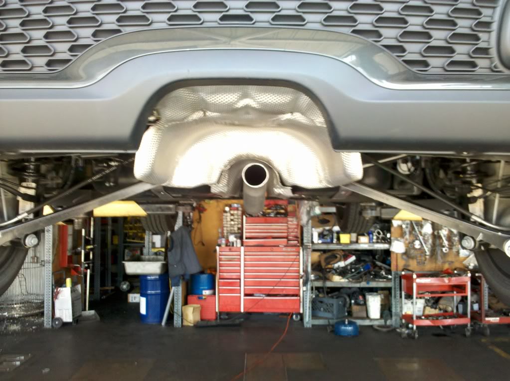

Update: Sold the Flowmaster yesterday to a guy with a Corvette. Welded on a Magnaflow 18" muffler with a 2.5" inlet dual outlets. Welded on the factory tips to the unit. The car is actually a bit quieter than the stock system now paired with the Magnaflow resonator. The performance is a little different. Much more low-end torque from the increase is back pressure. There is absolutely no drone at any rpm range now. There is noticeable increase in top end pull from this system.
