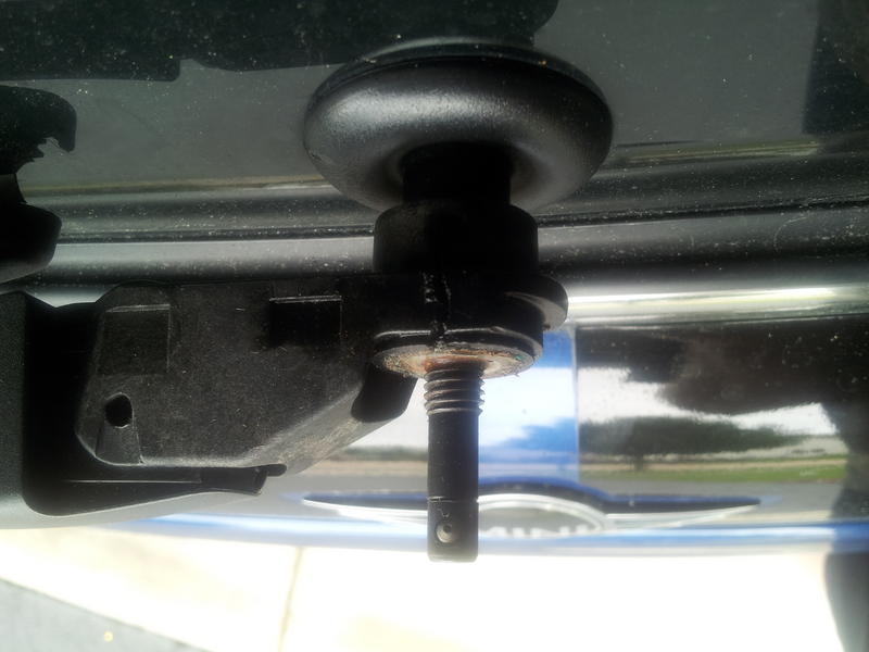

The nut was definitely tight. I soaked it with PB blaster for a few minutes and was able to get it off. Now I soaked it again because the arm is frozen to the shaft.
A couple things to note. First, the sprayer part moves freely, not easily, but I am able to turn it. The wiper arm resists turning if I try to turn it. Second, I noticed the wiper arm is cracked by the shaft but it does not appear to be slipping the splines since I cannot turn it freely. Third, I removed the panel from inside the boot and noticed the inside wet with wiper fluid. The hose is intact and it appears to be leaking internally inside the motor and leaking from the seal between the shiny metal shell of the motor and the black plastic mount.
Old Jun 26, 2013 | 11:21 AM
Posts: 36,762
Likes: 2,552
Thanks for the picture,
Looks like its damaged a bit on the internals, multiple issues going on. I would say to replace the motor which includes the shaft and nozzle. If you can save the arm to attach to a new one, if not i have the parts linked above. I would guess the reason it spins is that the nozzle is separate internally from the shaft and thus when spray pressure is applied leaks behind the trunk interior lid, leaking internally inside the motor.
The motor sprayer is one unit, so there are no other part number for the sections.
Thanks and hope that helps.
