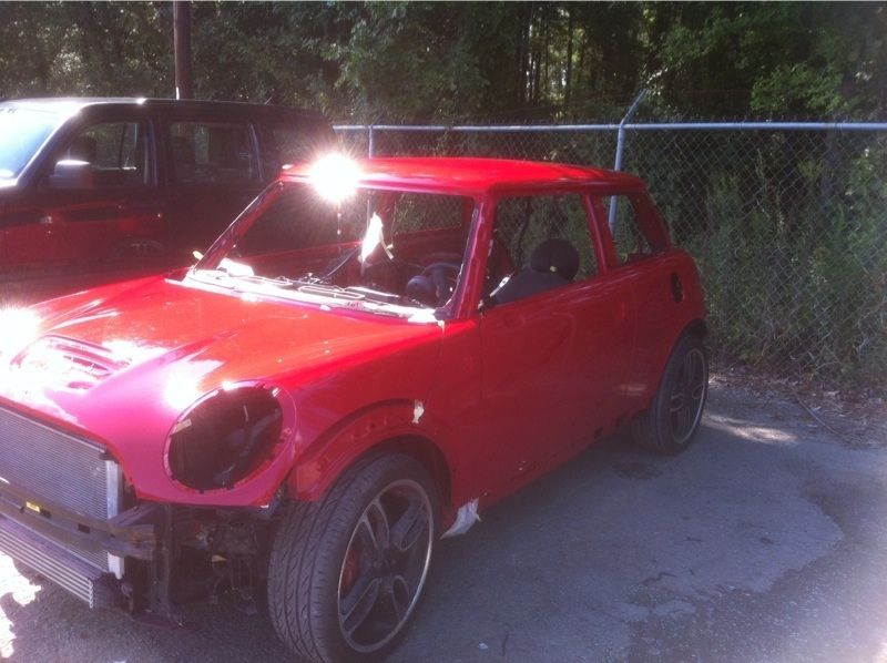

I’ll start this thread with Way from Way Motor Work’s R56 he’s building for the track.

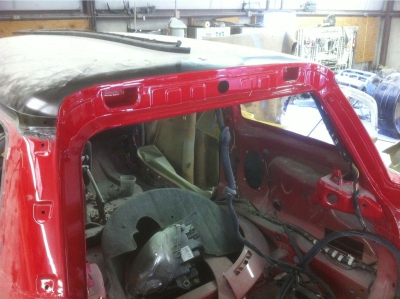

The car came to my shop bought as a rebuildable total.... I’ll start with some pics and update as it gets put back together.
Qtr panel in bodywork...
Qtr panel in primer...
Took old roof off, replaced with new roof and bracing for mini without sunroof.
rear hatch jamb painted/cut in...
This week the car goes into the paint shop. Front end is done, all necc. parts are cut in, radiator support has been replaced, suspension straight, we’ll send it into paint and hopefully have paint on it this week.
Quick pics of it painted....

The “sticks” are metal “studs” that are welded onto the panel and a slide hammer attaches to them. You then use the slide hammer to “pull” the studs out which pulls the metal out.
Point is, it’s a way of pulling the metal out without drilling a hole in metal and then pulling the metal into shape.
Make sense?

The pictures don't do it justice compared to what we started with. I saw it last week and it looks fantastic and Mark was able to save the original panels rather than replacing them.
