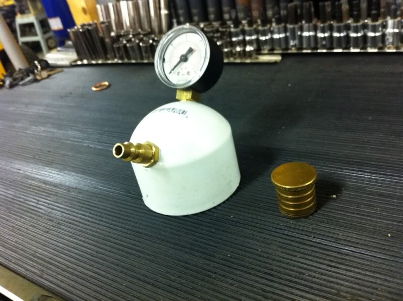

can you do a boost leak test on a MINI through the intake to the turbo? i know on my audi a4 I did this to find vacuum leaks. i bought a little kit from some site for like $8, its pretty sweet, im almost certain i could use it on my MINI. i know it suggested that you take the engine oil fill cap off the valve cover during test though on my audi, doub that would find a leak in the valve cover then though. so might try it with it on. just my .02 . good luck

From: Helotes, TX
6 speed - Good idea! I'll look into it. I've got 2 months left on my warranty, so I'll be a permanent fixture at the dealership until they fix this. But if they can't , I'll keep your test in mind.

Here is a picture of this boost leak tester. The white thing gets Put into your intake where the MAF sensor clamps on. And you plug your air compressor into the fitting on the white piece also. Set the compressor to 0PSi and slowly crank it up and listen. The little brass piece is a PCV valve plug I think. Idk if you would need it for this car.
And the white piece has a handy dandy gauge. Don't want to put higher than your car runs when fully boosted. So like 13-15 PSI for you

Nice! Do you remember what site you bought it from?

http://TurboBoostLeakTesters.com/ found it
Looks like $21-$25 plus shipping
