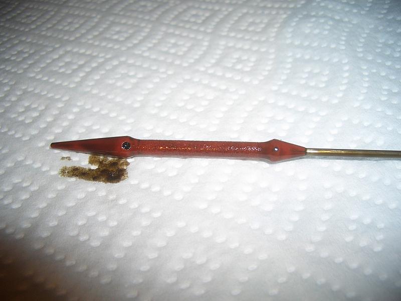

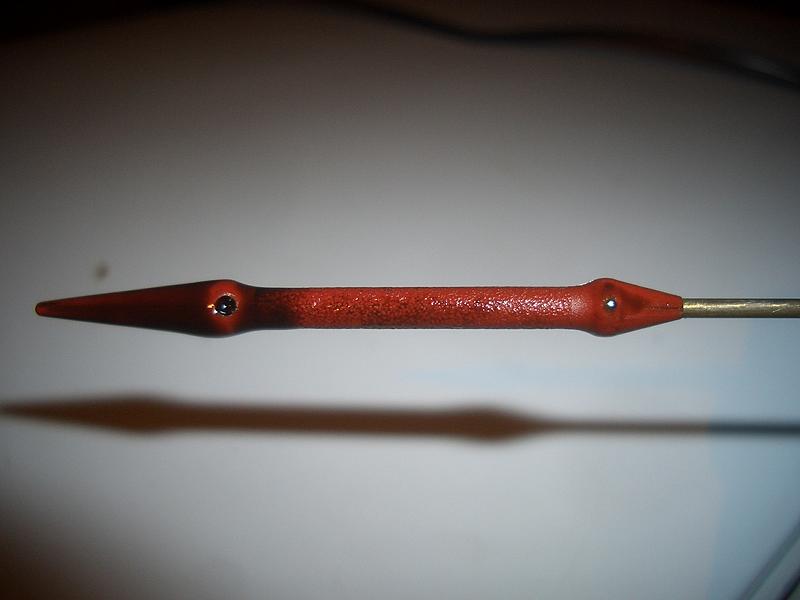

...The stupid dipstick... Please don't flame me, I searched the fourms and couldnt really come up with a definate answer on how to read it or what the marks mean. I have an 08. if someone could help that would be great,
I just wanted to check my oil i've gotten 15,440 miles and had the first change at 8000 almost a year ago. I feel like it should be low but I have not the slightest clue on how to determine by how much.
I did one check after driving home (30 min at highway speed) and got the first image below (CIMG8610)
and then after trying to find a thread on here to help I went back out when the engine was cold, ~1 hour 45 min sence shutting off and got the second one (CIMG0018)
after checking a second time I feel like it looks to be on the low side.
If someone could help that would be great.

As long as the oil falls between the two ***** you are okay. It appears to be on the low side of okay but still okay. I like to fill mine to be 1/2 way between the two *****. Do not fill above the top **** as that can cause other issues with oiling of critical parts. Bottom **** should be approximately 1 quart from 'full'. This info is for normal driving, high rev uses changes what you can do as far as 'over filling'.

I would add about 1/2 quart to get up nearer the top mark.

I will never understand why Mini made a dipstick that is so difficult to read. It's like they found a material (teflon?) to put on the stick that repels oil. Your oil is dirty so it is fairly easy to see you are almost a quart low. When the oil is new it is much more difficult to see. I filed a couple of grooves in my stick which makes it a little easier to see but not much.

The oil is dark in the pictures which can mean dirty oil, clean or new oil is hard to see on the dipstick. This does not mean your oil is due for changing. Oil can get dark just after a couple of miles of driving in part due to left over old oil during the change. The oil is below the half mark. The two ***** represent approximately one quart. This means that you are more than a half quart below the 'full' mark. Still not an issue since you are above the low mark. If you were to add oil at this time you would need to add less than a quart of oil.

Look at the second pic in the first post. The dark oil line just to the right of the lefthand metal eye is obvious. That eye/plastic bump is the low oil level mark, so it's OK, just on the low side a bit. In the first pic the oil was hot, so there's only a very faint darker line to the right of the same metal eye. The oil should be checked cold, like the second pic.

It was pretty much a quart low so I topped her off with a fresh one of castrol synth 5W-30.
I hate that dipstick with a passion... I understand now that its one quart from full between the bulges but still it can be difficult to read when the oil smears all over it when you pull it back out. its just not a great design. apparently the new ones are a threaded rod and I hear those are worse.
