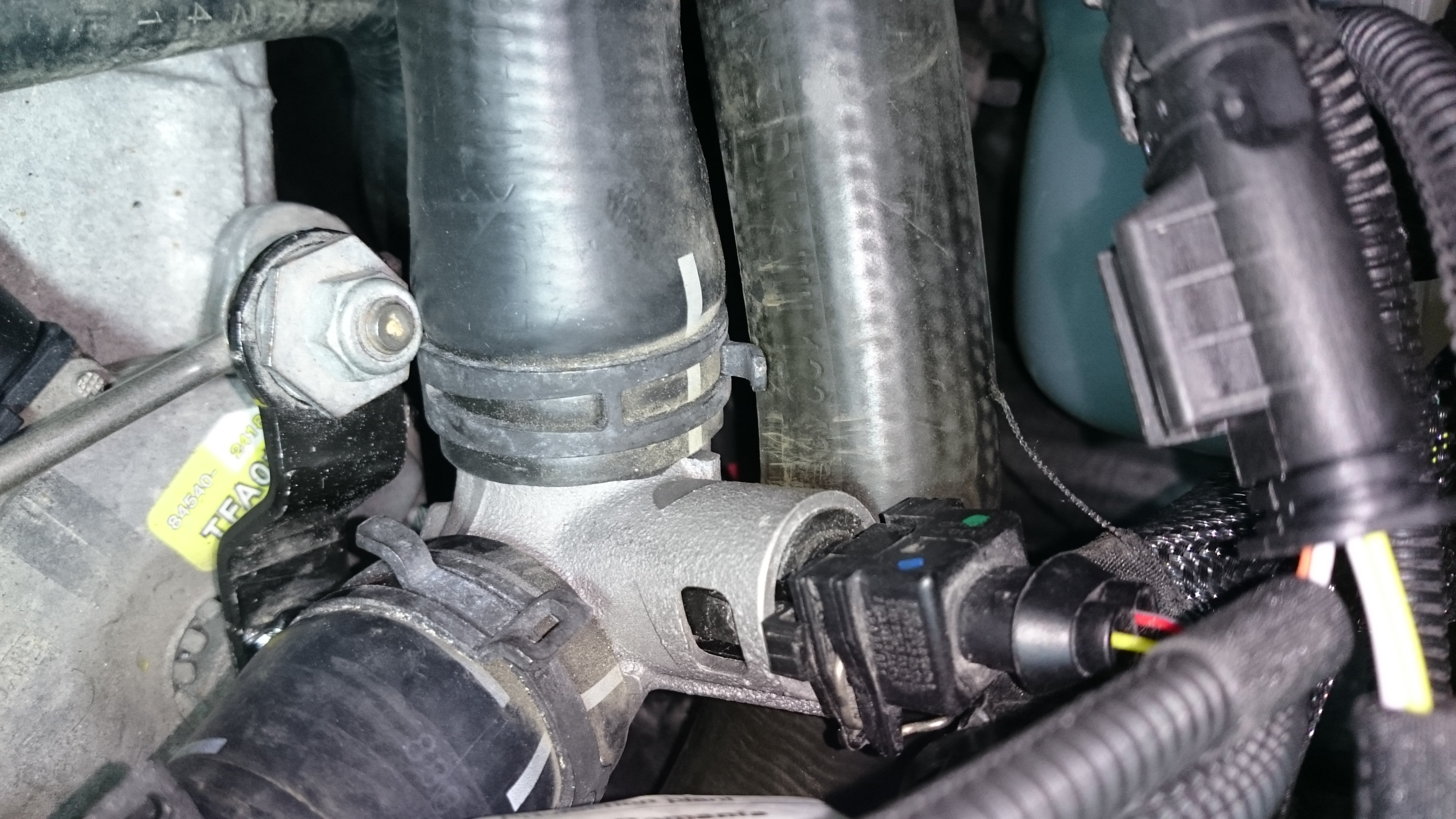

thank you for the guidance. So, this has helped me narrow down what's going on. When I shift from P to R to N. The end of the shifter cable with the nut on top interferes with this coolant hose/pipe.
The question I have for you is, is this shifter cable/nut assembly supposed to clear this hose and go underneath it? Or does the hose need to be pulled out more from the ends where the cable clamps are? I know when I reconnected everything after changing out the thermostat, I pushed the hoses down to the base of the couplers and thermostat housing. I pulled it out some, but I think I need a good half inch more before I can remove inferences, if half an inch is even achievable. I'm not sure if this is the right approach and wouldn't want to do this if the shiftercable/nut/lever is really meant to go underneath it all. If that's the case, I not really sure how to go about this....
If someone can tell me which approach to take, I would appreciate it...
The attached picture is when the car is in Neutral after I pulled the the interfering coolant hose in the picture back a little from the base of the thermostat housing.

From what I've been reading on this thread --- transmission was shifting normally before you changed the thermostat. After changing the thermostat, the transmission wouldn't shift properly. We gotta assume you didn't mess with any of the linkage during the replacement. If you used parts from a Mini dealer, all should have gone back together nicely --- maybe minor hose-to-fitting adjustments. If you used parts from the local parts house, you should compare the new parts to the old parts to ensure you have the correct ones, and not missing an extension that would raise the thermostat a little higher. I'd try rotating the thermostat a bit, to move the hose connection farther away from the linkage.

thanks for the reply. I'm not sure if it's easy to tell in the last picture I attached, but the interference is quite a bit. All I changed was the thermostat/housing which was from the Mini dealership. They did say that they "redesigned" this part, although I couldn't say what all the differences are. There is probably some amount you can move the thermostat in terms of positioning, but I am certain it won't be to the extent that would remove the interference.
In any case, I was able to pull both ends of the hose out to the maximum extent which allows the clamp to still engage just before the lip on the coupler and the lip on the thermostat housing. I'm not sure if this is how it's supposed to be. But I am now able to shift in to drive fully, however when I am in drive, the nut still just touches the hose, barely. I'm not sure if vibration could be an issue long term. I'm still open to any suggestions on what the proper assembly should be. At least I can drive the car again, and I didn't have to spend $800 on a thermostat change!
